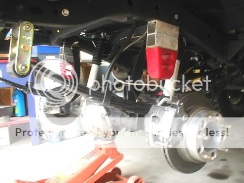

I went with AN fittings and hoses, the calipers are metric GM and Speedway has all the fittings to adapt them from metric to AN along with the ones to go from your existing brake lines to AN. I even eliminated the bongo type fitting on the GM calipers with there fitting that screwed in to the caliper with a male AN fitting on the other side for the hose to screw directly to. Get there round track catolog, they have alot of good builder parts that us Jeep guys can use...I can take other pics if it will help.
