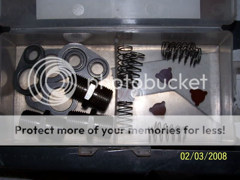

fuzz401
you looking for the flap and the spring and the ring to hold it in place

Thanks for the photo, Fuzz401, and for answering my need for parts, tufcj and mkzmomo, and the link to performance american style, dwloop. I shoulda came here a long time ago.

Look what I got from MC today. So, do I just remove the oil filter and stick it on or ..... haven't even looked at the process yet.
Thanks MC
Remove the oil filter, remove the threaded nipple, replace the stock parts with the new piece. Pretty simple.

The stock piece looks like the part in your hand. It's already in there. Take it and the little fiber valve out, throw them away, and put in the piece in your hand.
It will be pretty obvious once you take off the filter.
