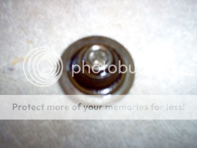

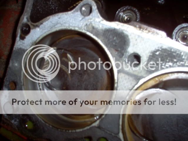

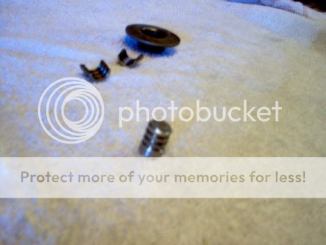

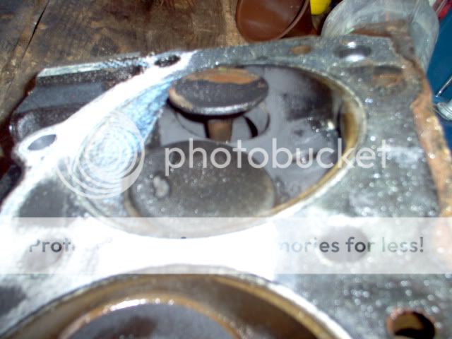

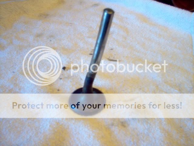

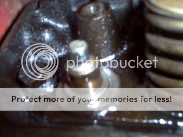

I unfortunately found the problem today. Broken exhaust valve. Did a compression check and the last cylinder I checked there was zero compression! It is stuck in the open position, I'm guessing that's why I was getting pulsating vacum readings. The spring was still sitting like it was all there until I looked close with a light and didn't see the shaft of the vavle. The rocker was going up & down but with no vavle there. I'm going to pull the head tomorrow and see how bad it is. If the piston didn't hit it and make a mess of things, I might be able to just replace the valve.

If the shaft isnt there where did it go? did the keeper pop off and fall into the oil pan or did the shaft break and the valve fell into the cylinder :shock: If its in the cylinder I would be concerned for the piston. Make sure to post some pics if its broke good :razz:

did it mess up the valve guide at all? :shock: I would at a minimum measure the valve guide and make sure its not ovaled or screwed up in any way or you might end up with a stuck valve and more problems. cant be too much to have the guide replaced if its bad
