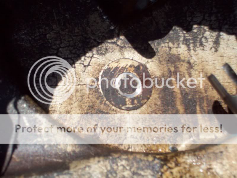

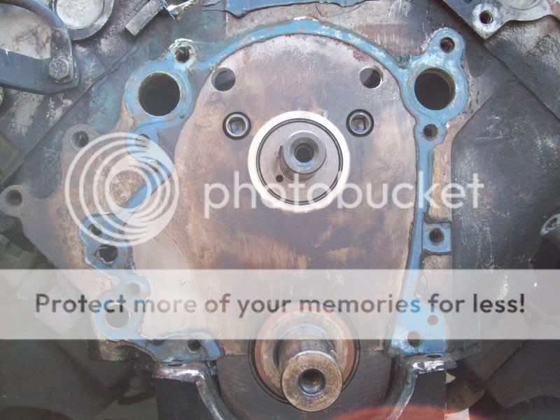

Ratman OK thanks for the info here is a update. I got the cam out and the berrings at least the front 2 are pretty rough on the top side. So they gota go. Heres teh question. Do I rebuild the 304 ? do I spend about the same amount and buy a 360 Long block? The carb, manifold, Dist, timming cover ect... are all brand new or in great shape. Thanks
Ibby I bought a 304 long block 2 years ago to replace one that I cooked. I have to say, if I had to do it over again I'd go with a 360. I had an RV cam put in which made things better, but I think I'd have been happier with the bigger motor.
