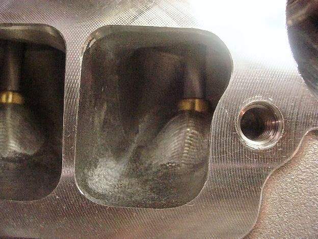

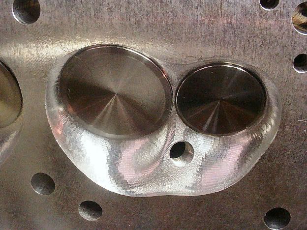

Ok its Monday night and here are pics and #'s as promised.

Intake Valve 2.14 Exhaust valve 1.68 (Stainless)
Flow tested on a Superflow SF 600 Flow Com
