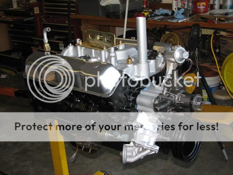

Now I have checked and timing was ok, new pushrods from summit were about 8" and old stock ones were 7 3/4 (previous post), Now I need to tighten down the rockers. The lifters are not pumped up and I do not want to over tighten them at this point. I tried the spinning technic but they still spun as I tighened them all the way down. What would be a good starting point until I have the engine in and running? I want to get this in soon. Thanks for the help.
The valve covers and intake are just sitting on top to keep crap out.
