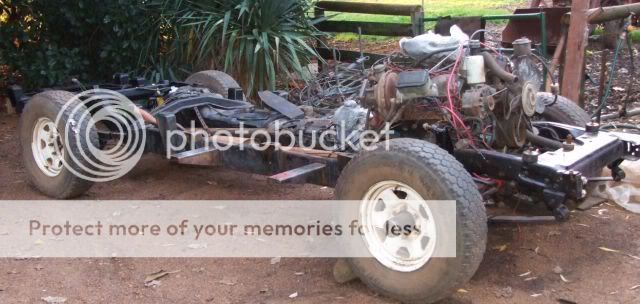

3 years ago the 258 was getting a little tired, so I decided to put a second hand 360 in it, I got a 360 out of a J20.
I purchased some SJ V8 mounts and mated my 258 flywheel to the 360 ( Not a good idea after reading on this forum, using the 258 flywheel on a 360)
and bolted it up to the T176.

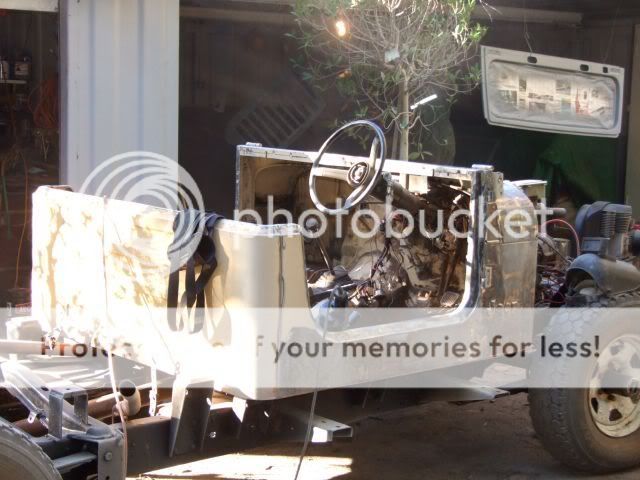

Ran it occasionally over the last 3 yrs until the rust and the Tiring 360 became too much, Then I decided on a partial restore which has turned out a little bigger Job. as you can see in the pics.

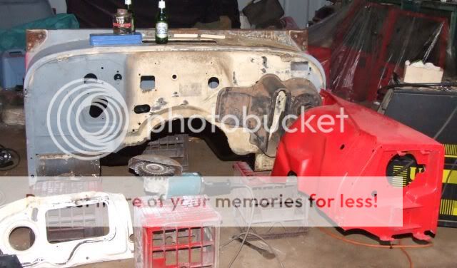

I was just going to patch it up , But I have decided on a full respray and cut all the rust out and put fresh metal in, Do it correct !!!!

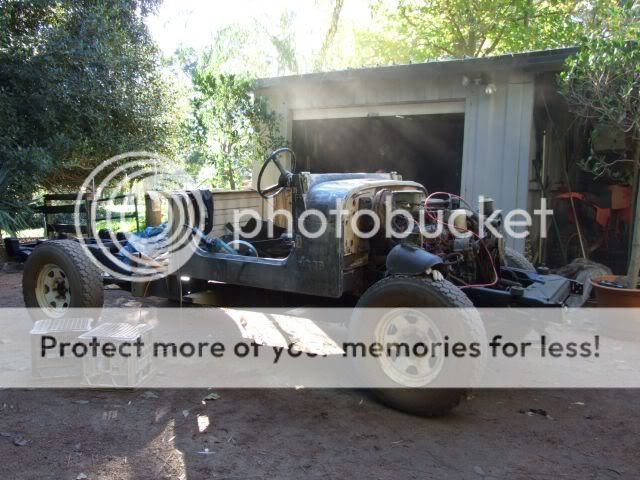

Starting the strip down

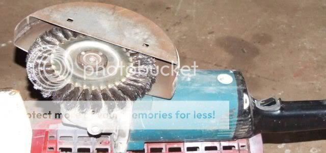

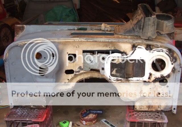

Tub back to bare metal using a 9" grinder with a wire wheel

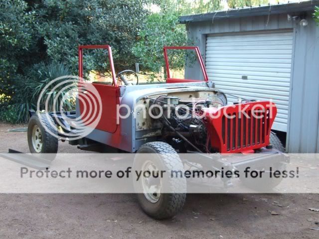

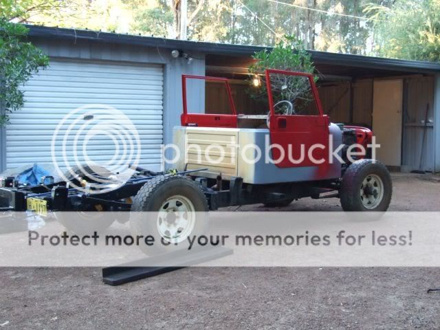

Put some color on a few panels and put them back on the tub to see what the color looked like
We all know RED is faster :0
I chose GTO Red (Sting Red)
Same color as my GTO

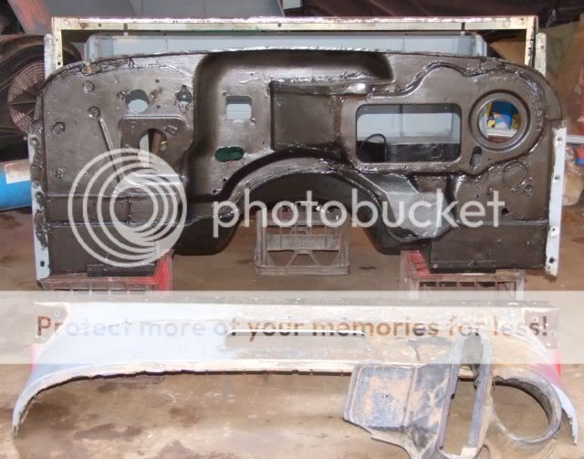

Since these pics were taken, I have pulled the tub of the chassis and made new floor panels up and a new piece for the Firewall and painted the floor with a similar product to POR15, as I couldn't find POR 15 available in my state
