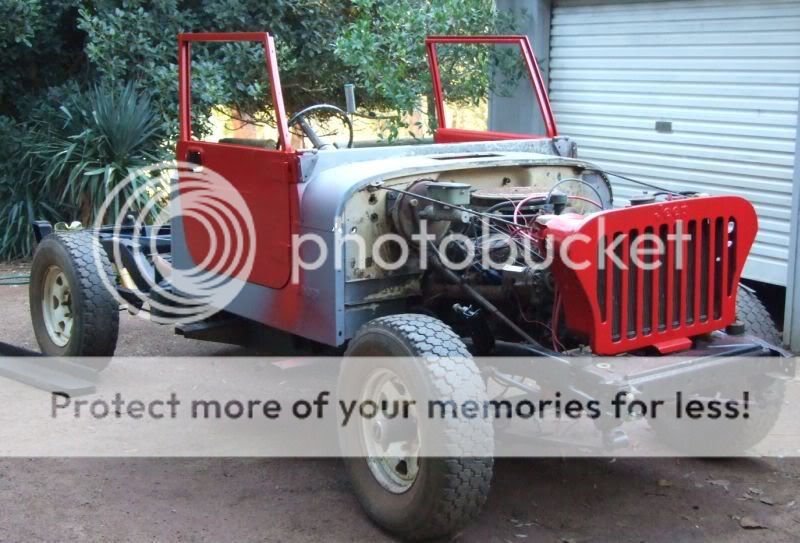

Here is a couple of pics, I am slowly doing a restoration on the CJ10.
I temporarily have the 360 fitted with the 258 flywheel so I could do the engine mounts and cross member
