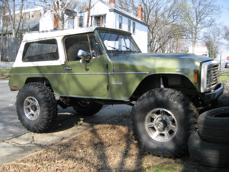

fifesjeep I never liked the look of the Commandos but that is actually pretty good looking.... maybe it's the tires :mrgreen:
Goose Commandos are cool.. (I could have done without the late model grill change but the earlier ones ..) anyway 300 hp, thats pretty easy out of a good basic bottom end and the bolt ons you are talking about. For oyur application I would clean up the stock heads (maybe replace the valve springs while they are apart) I would bet , with a decent torque cam like Edelbrocks and the EFI and headers, and upgrade the ignition like mallory you should see 300 hp, And more importantly for your application about 300+ ft lbs torque..
