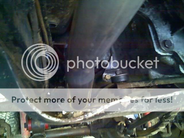

We did something similar to Mike4089, but went over the top. The floor sure gets hot! Here's the way ours came out...

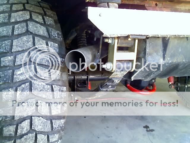

2 1/2" into muffler, 3" out. Sounds BAD, meaning GOOD!

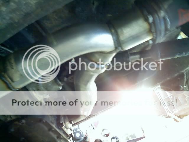

We used stock exhaust manifolds, and crossed over above the transfer case. We couldn't run true duals because of the anti-wrap bar being in the way on the passenger side. We have a 3" body lift, so that helped with getting over the t-case. Still need to add some insulation above the pipe as the floor gets pretty hot there by the cross over.

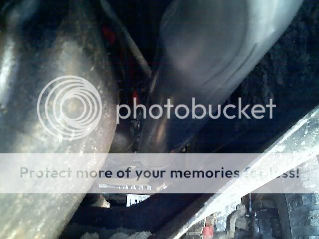

The muffler is a single inlet/dual outlet glass pack flipped around backwards. It is a little too long and kept us from humping the pipe up over the rear axle to give it clearance like we wanted to. Next time will look for a shorter muffler.
