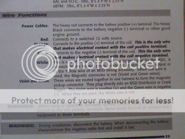

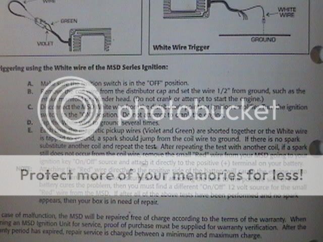

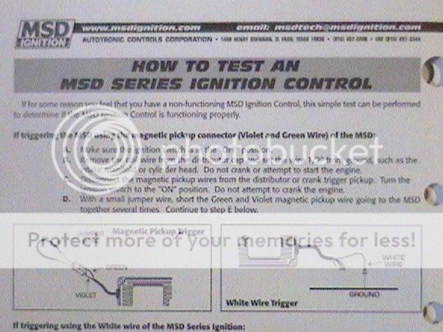

This is for triggering it with the white wire...you shouldn't be using the white wire with the MSD Dissy. But it will do the same thing jumping the Green and violet wires.

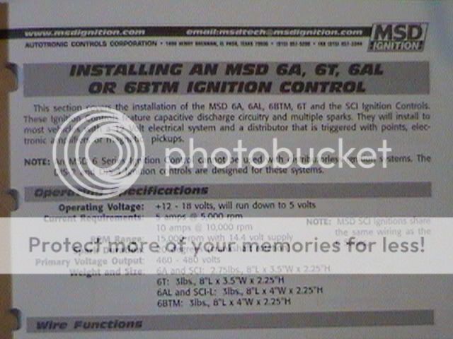

Sorry about the pic quality...my scanner went south awhile back. Hope this helps!
