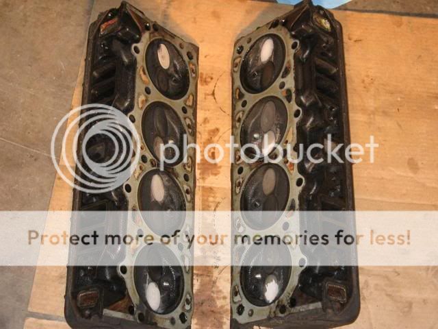

Guess what I did last night.... :lol: Dropped the heads off at the machine shop today. $175 will get me a cleaning and new valve seals, and a grind to mill her flat. From the valves, you can tell she was burnin' the oil. Can't wait to put her all back together with the new tranny and 4:1 in the D300. They're willing to mill as much as I want. Any suggestions on how much would give me an extra 0.5 in compression while causing no big issues (Edelbrock performer cam and intake, and Shorty headers soon).
