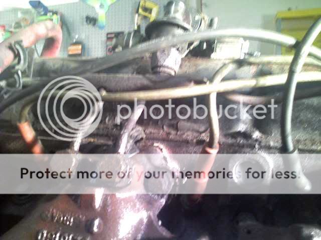

tufcj wroteThose are high flow doglegs, all the exhaust manifolds since 1971 are. They changed the dump on the drivers side from just behind center to the rear in the late 80s, make sure you have the correct driver side manifold.
Those fittings might free up if you know someone with an oxy/acetylene torch to heat the fittings red hot.
on FSJ's the dump on the driver's side changed in 80 when they went to driver drop front axle, If you can get oxy/acetylene or a MIG welder, just trim the tubes off and weld the holes shut where the tubes attached, had to do it on vehicle on one of mine.
