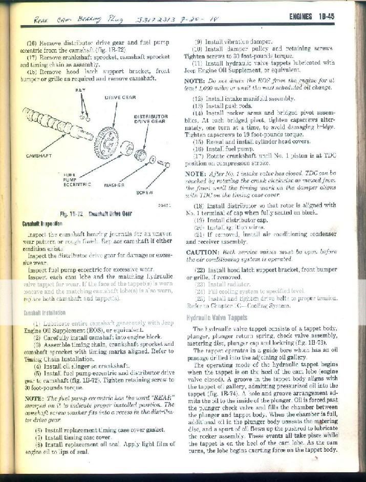

jharlan68 Just ordered matched set of dizzy/cam gears from MC. The thing is: I need to know how to install the cam gear and make sure they mesh properly. I have a CJ with a 360, HEI dizzy. Can y'all give me some advice? Thanks
jharlan68 thank ya. Got the gears yesterday and everything tore down. Hope to reassemble tomorrow or thursday.
