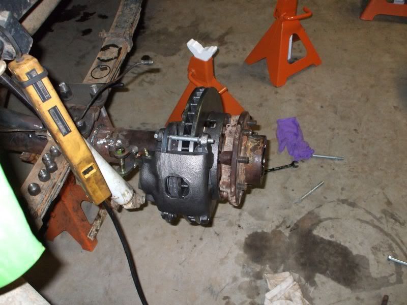

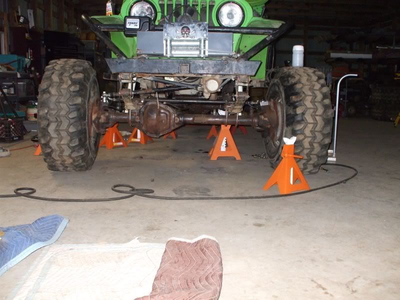

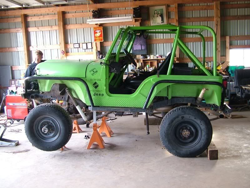

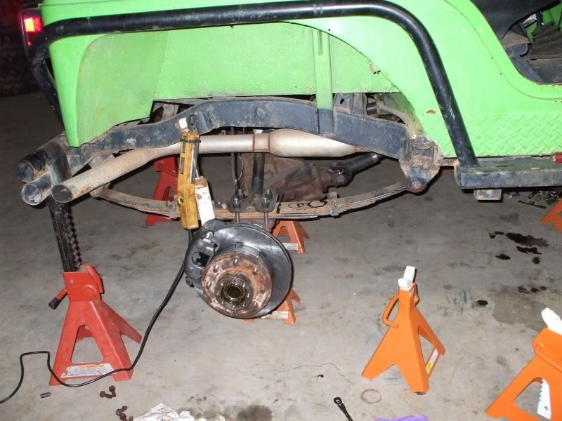

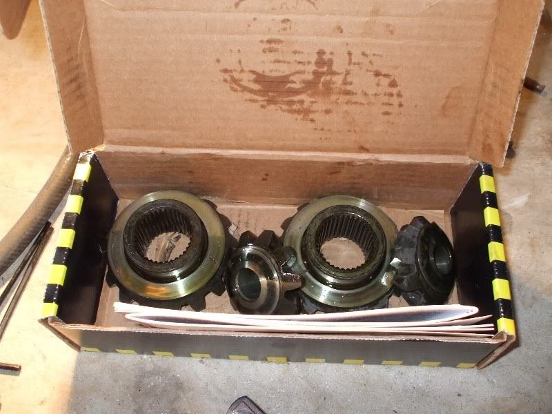

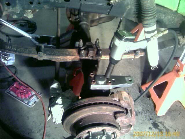

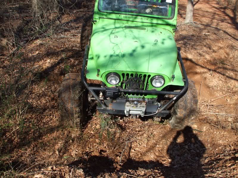

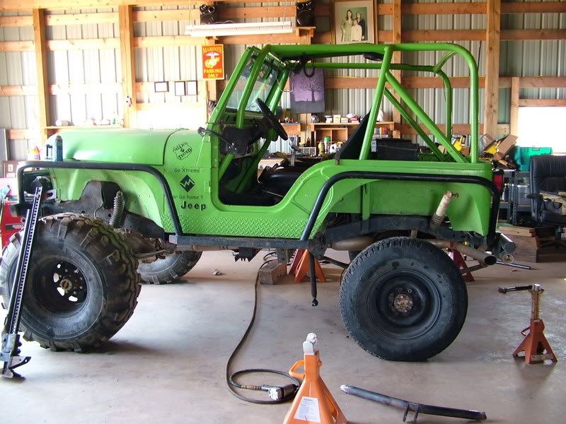

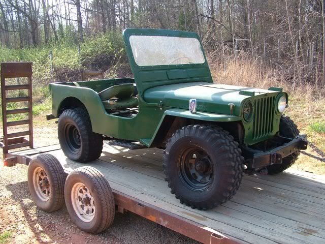

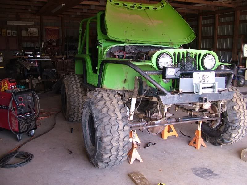

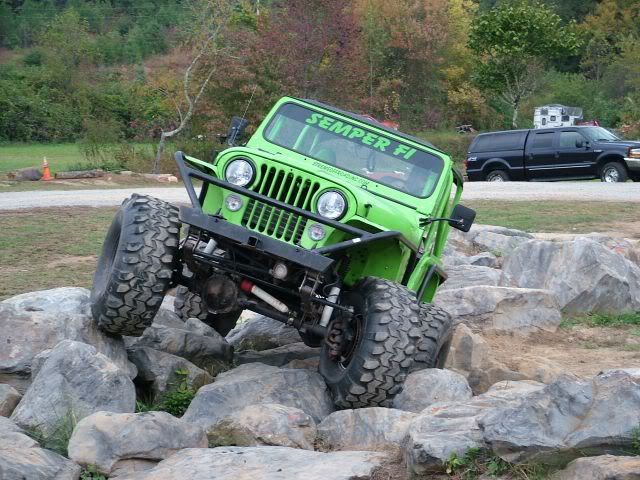

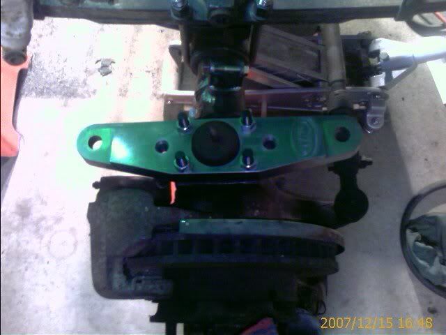

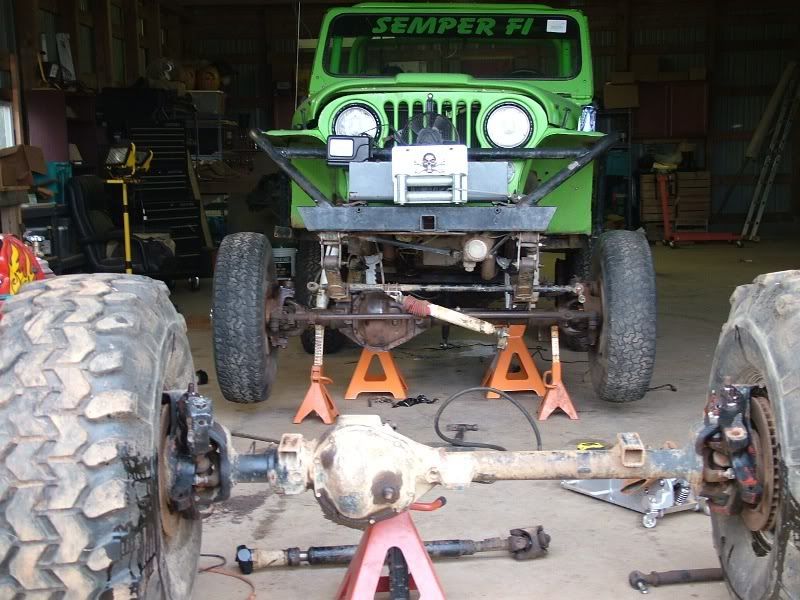

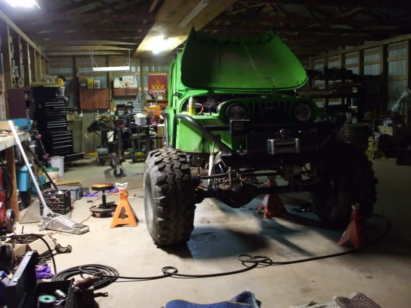

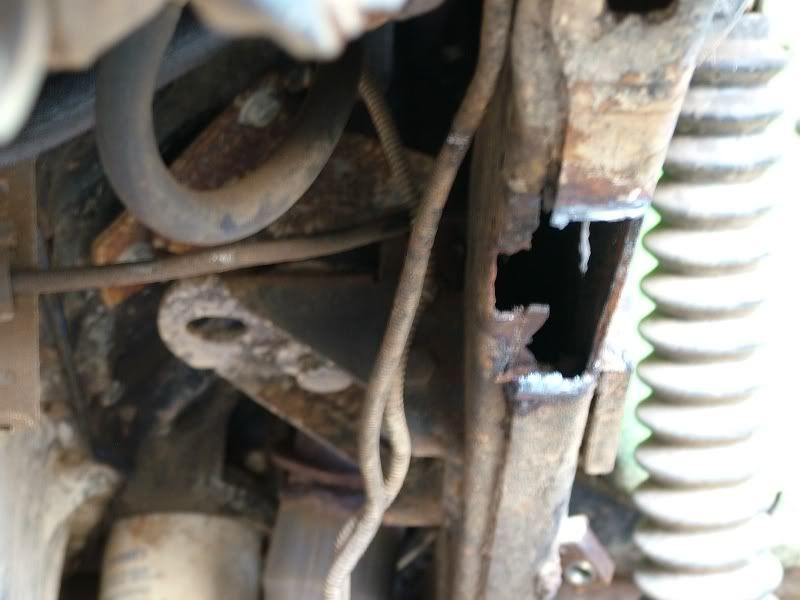

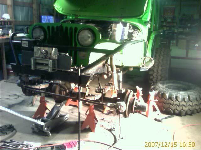

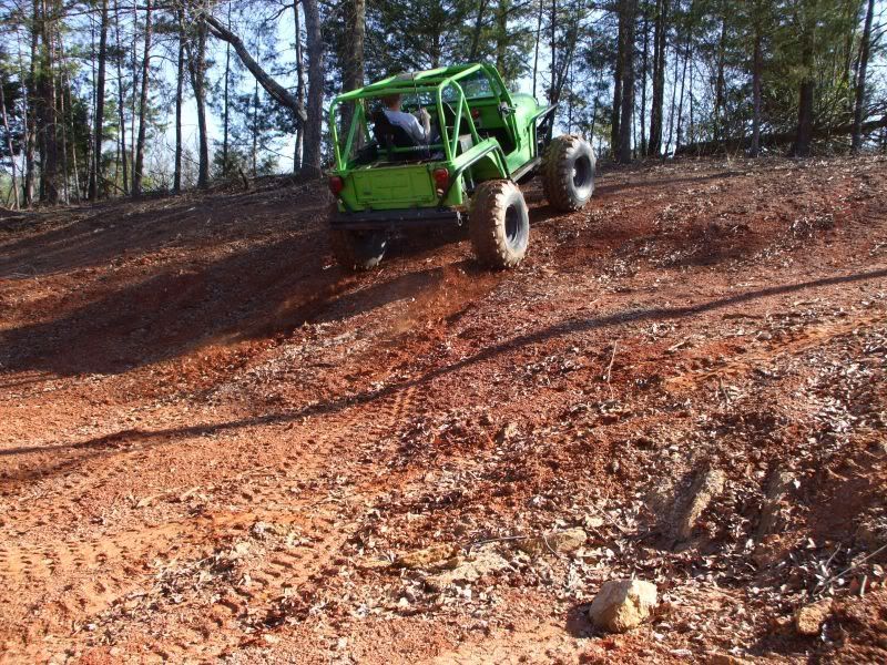

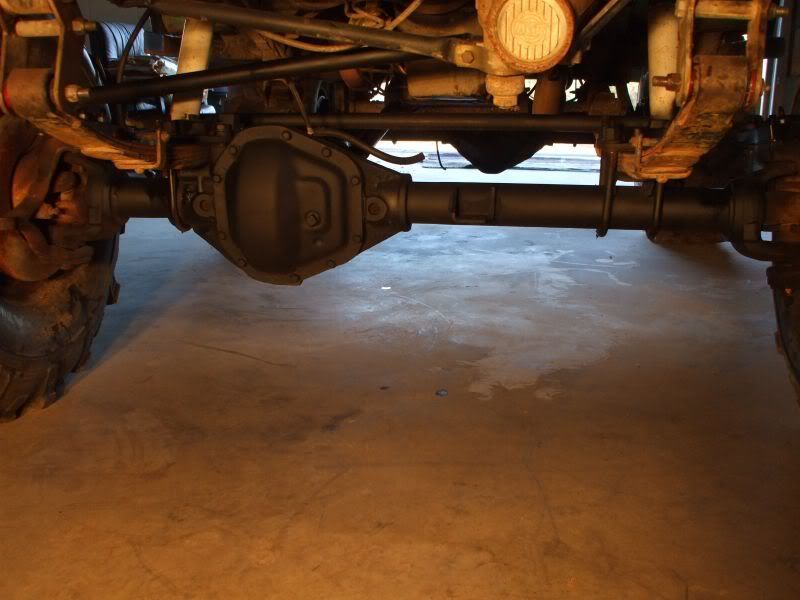

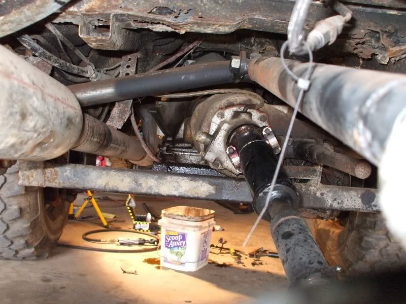

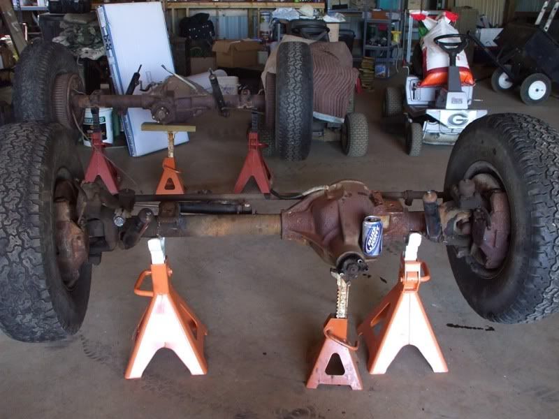

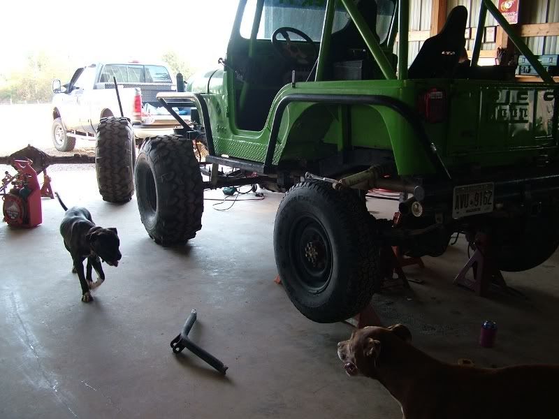

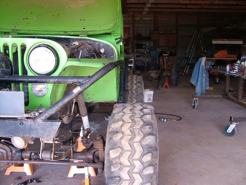

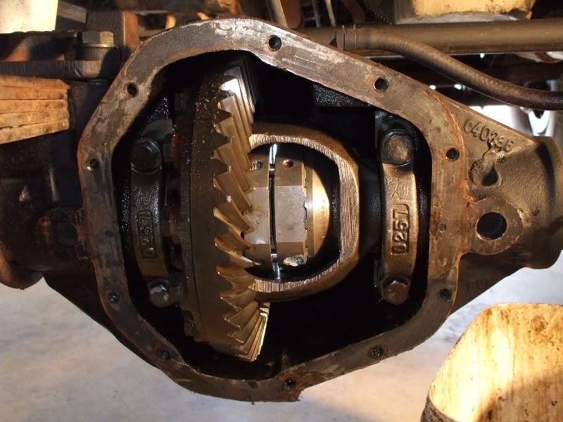

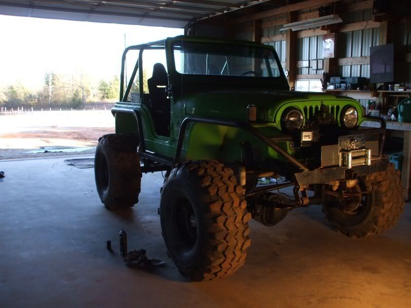

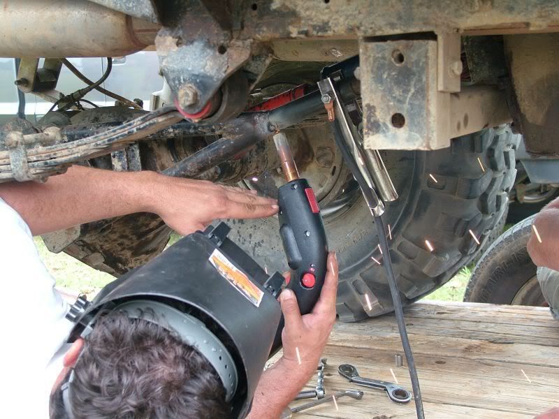

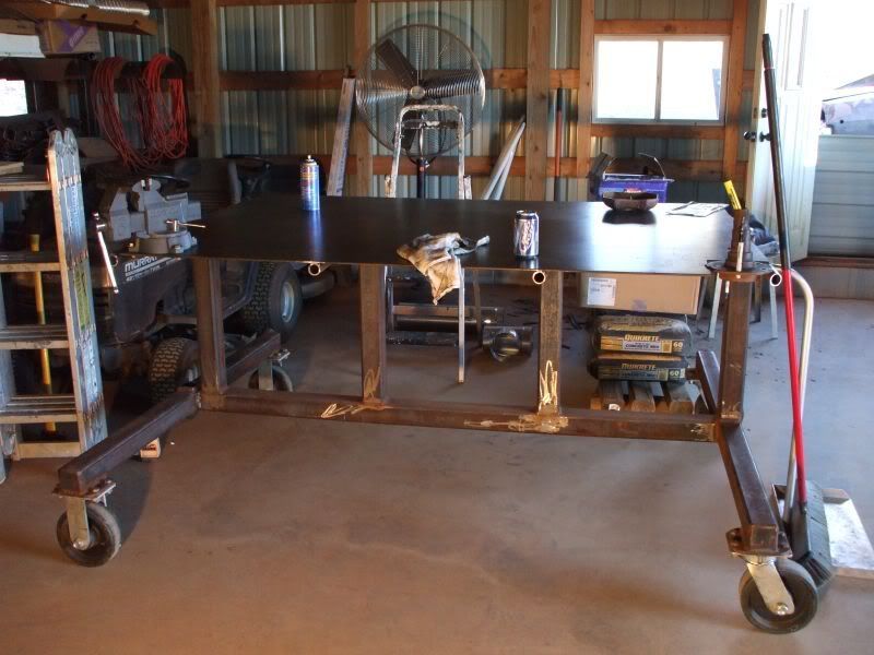

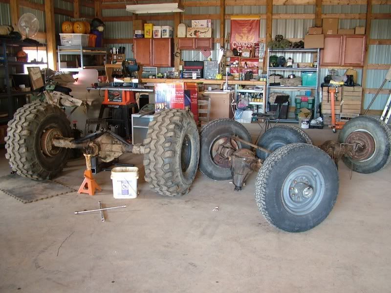

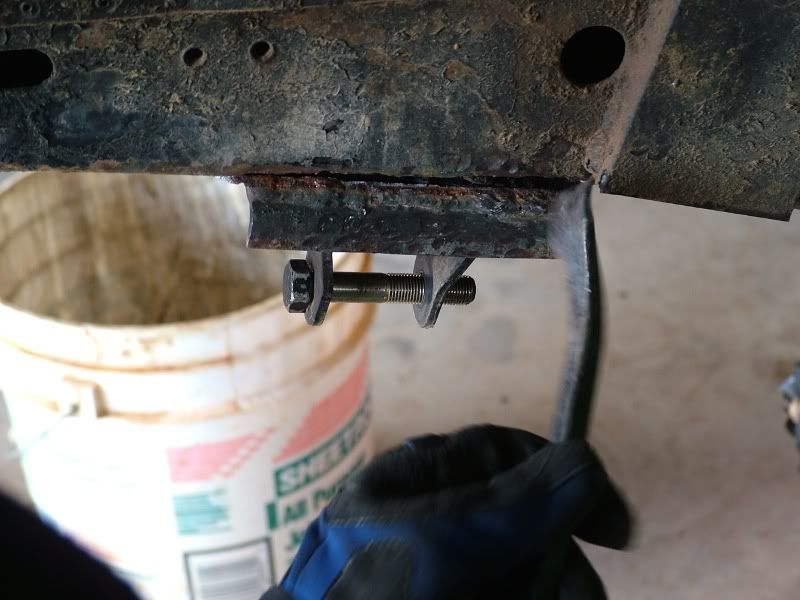

cj5 buggy Soooo MC & Mud... ya'll ready for April? :razz: i know ya'll like Pics... before swap... 383 stroker, th350, D300... 14 bolt 4.10's detroit, Front was a Scout D44 with ford 8-lug outers... held up okay, until i got up here in GA and started with the rock crawling, and lack of grease... dana 44 started going pop .. so time for 60/14 bolt combo... the shop... axels... 60/14 out of a CUCV 4.56's and detroit in the rear. out with the old... in with the new... can't for get about the hounds.... then starting on the front, then where the track bar was welded to the frame, rust = time to repair... the fronts is in at least... WFO highsteer you can see the frame repair in this pic... yep i had to get my own heat... man is she Fat clears the shock... rear disks... they're just thier for mockup... i still need to tear them down and paint... :mrgreen: our other vehicles... the wifes 93 YJ... the pick'em up trucks... 55 and 57. ones is going to be her flatbed truck for tooling around here, the other will have rockwells and who knows what... our golfcart... the 49 flatty (my personal favorite) never finished right? but she's ready for a trail ride... definatley need a front locker, and time to get the propane on... Dutches... Jason's pooch... and mr. wrinkles... the welding table that we built... finishing the shocks... me my buddy jason mounts made room testing painted the axles... finished couple vids... ordered a lockrite for the front and going to bleed the brakes a couple more times and should be good to go. hopefully will get the propane running soon also. :mrgreen:

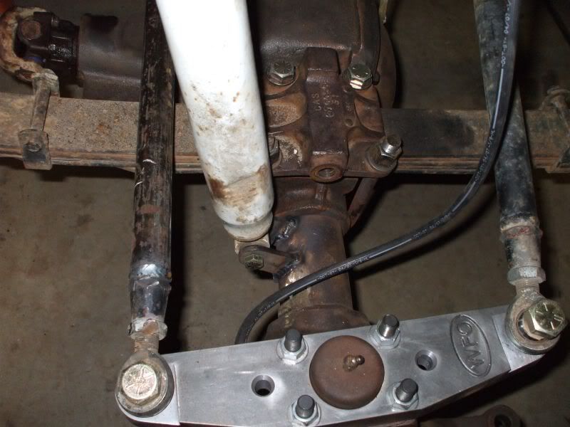

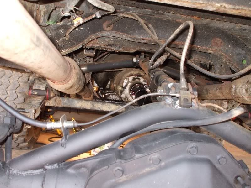

dan58 Did you get 35-spline outers for it? You'll want them. :lo1l: What are you running for a traction bar on the back? I spied a truss on the rear dif.

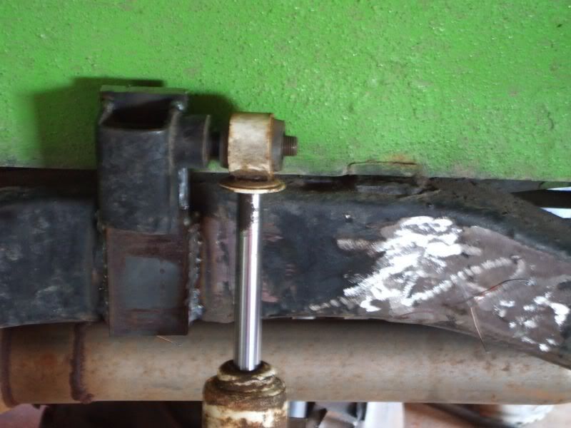

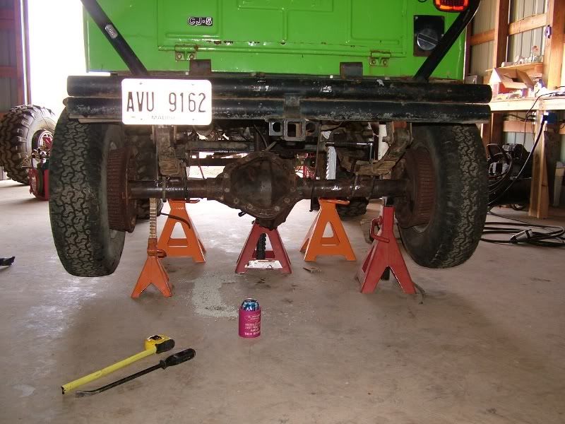

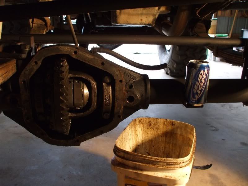

cj5 buggy i haven't got the 35 spline update yet... i'll run it till she POPS then i'll go for the upgrade (Hopefully the price will drop) as for the rear... yes i have a truss setup in the rear... i'll get some better pics of it this weekend. this was the old setup... which liked to go POP...

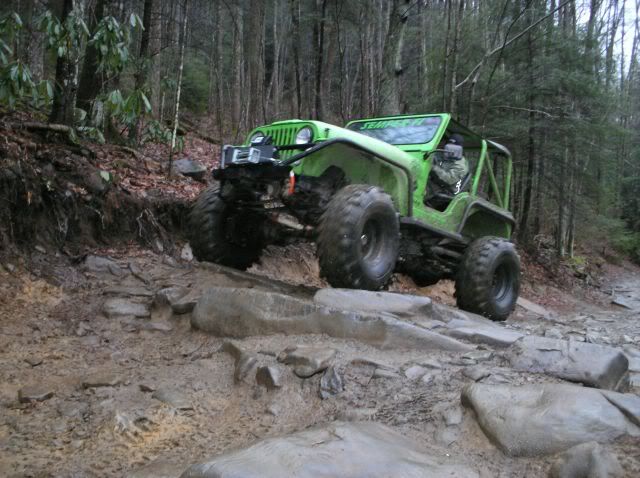

jeepsr4ever Frankie...sweet! Now its going to be harder to break when me and Pat steal it :?: Nice shop there as well!
dan58 You should be able to upgrade the outers for about $400 or so. It's not cheap. :oops: I went with Yukons inners/outers, Spicer joints, and the Mt Logan flanges. If you don't HAVE to have hubs, go for the slugs. :t:

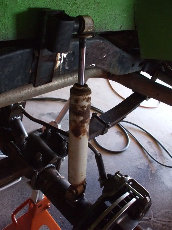

Mudrat cj5 buggy wroteSoooo MC & Mud... ya'll ready for April? :razz: i know ya'll like Pics... :mrgreen: Don't know if I'll be ready or not, I have shoulder surgery on Feb 29, may still be in physical therapy. :smile: :hathat34: Jeeps about ready though. Last bit is figuring out longer rear shocks to handle the droop and installing the 727. =D> Then putting putting all the bits and bobs back on, gunna be tough with only one arm :oops:

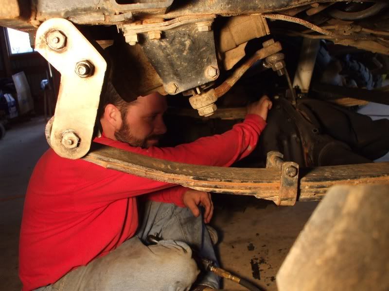

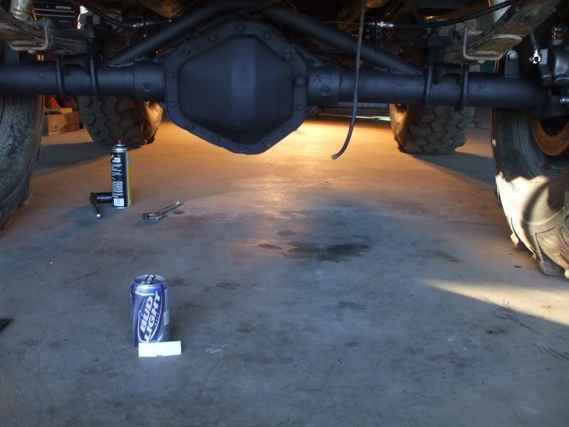

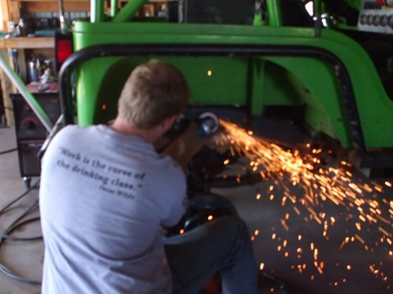

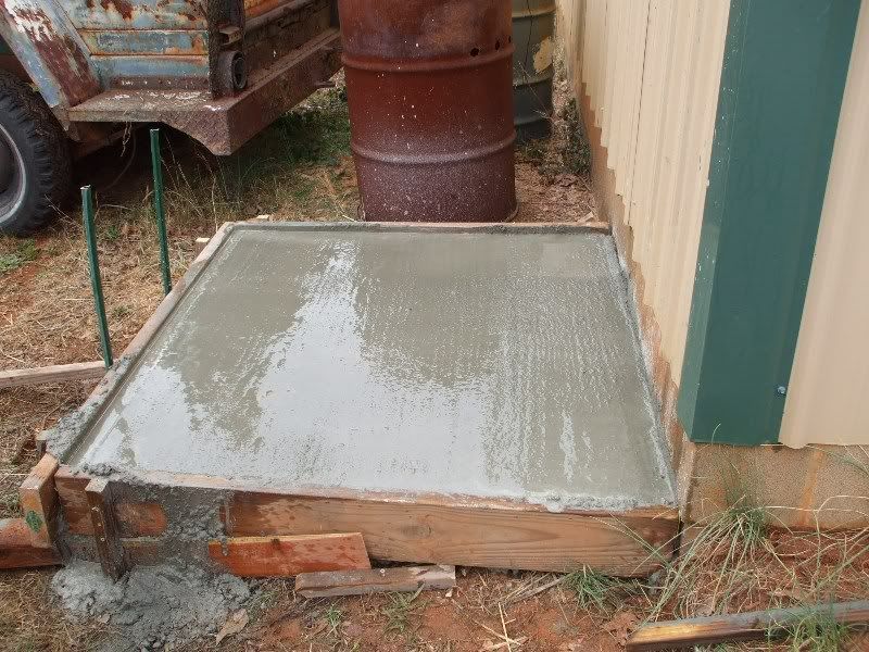

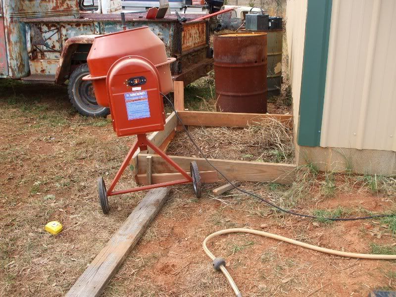

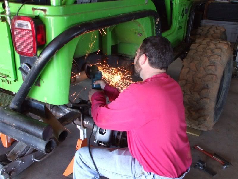

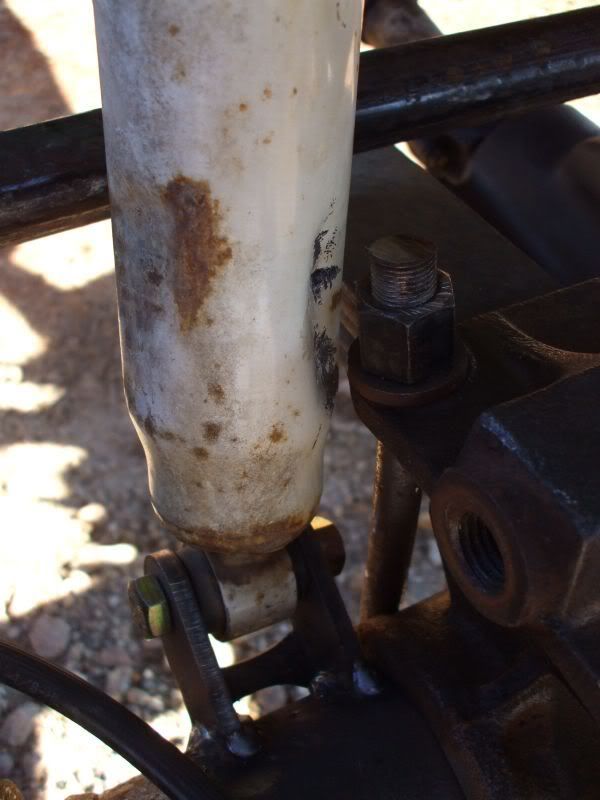

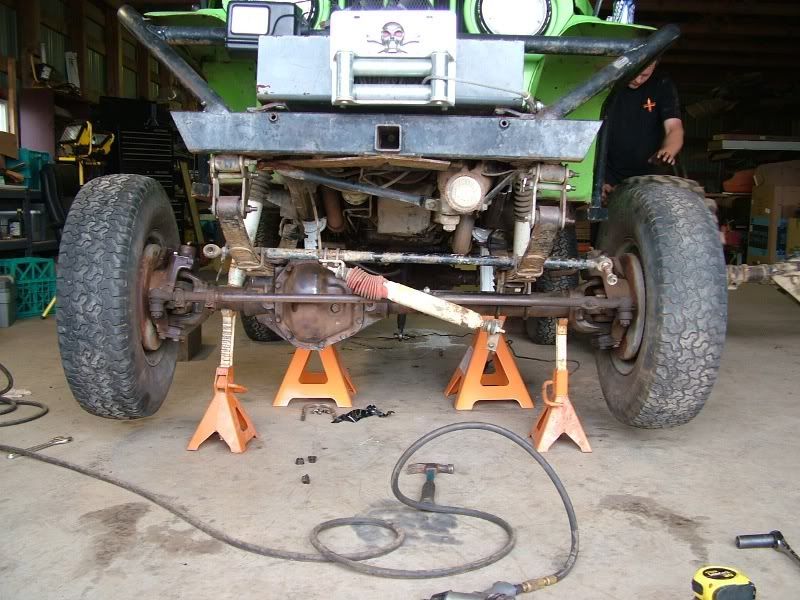

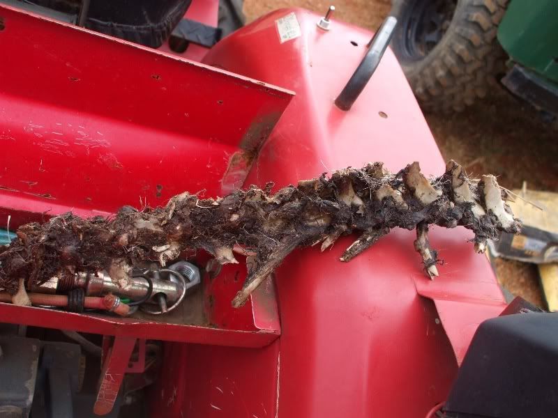

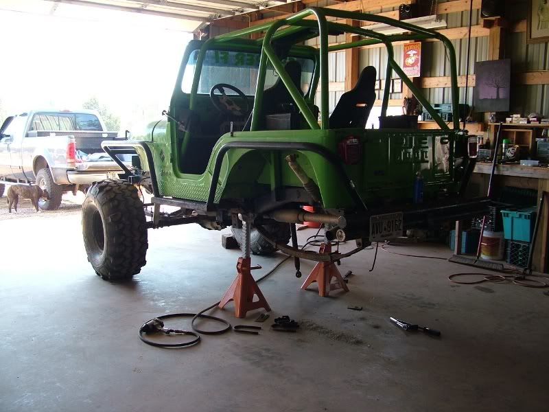

cj5 buggy some pics from today... out with the old... in with the new... see i do manual labor... close up of the rear truss.. since we had time for a break, the wife wanted us to help get ready for a new air compressor... the one we have won't even tighten or loosen the bolts on the diff cover. which means this has been all manual labor build... the wife cut herself building the form... anyone wanna guess what the dogs found in the back yard? :mrgreen:
ironman_gq Looks liek a deer to me :idea: . We got lots of them turning up in the spring after the wolves and other critters clean up after hunting season.
