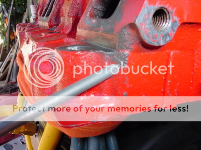

here's where the crack is, it also looks like it goes about 3/4 to 1" along the 90 dgreees. what do you think, like i said all new parts on it.

That's actually a very common place for AMC heads to crack (especially 291-Cs). I've had a couple fixed and pressure tested and put back into service.
What usually causes that is too much torque on the bolt too fast. I torque the heads on in at least 3 stages. First pass at 30, then 60, then 2 passes at full torque. Haven't had one crack since.
Definitely fixable. Take it to a shop that specializes in heads though, not just the local welder.

thanks you guy's, now to find someone who speacializes in head work.
