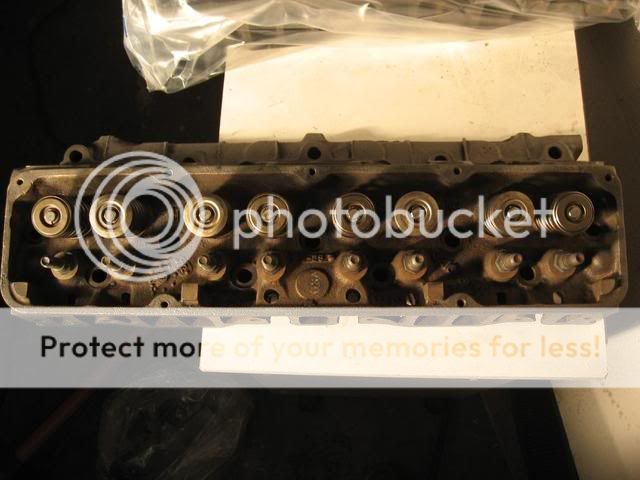

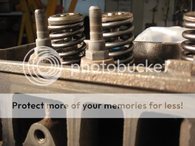

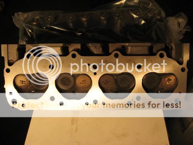

I got the heads back today. Rhodes Machine shop had to do some additional machining to use positive-style valve seals. They also machined them and put in new freeze plugs too.

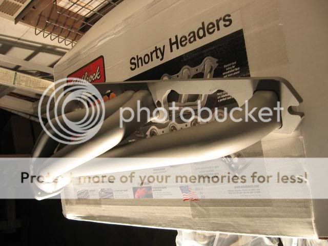

Headers from a local feller.

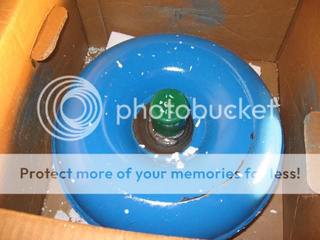

New TQ Converter (some place in Pittsburgh) This is a higher stall, NON lockup TC for a TF999 (which is a lockup coverter). It's a custom unit which should make the tranny live a LOT longer behind the V8. I took the old one to a shop for a quick teardown, and the first gear bands were completely burnt.

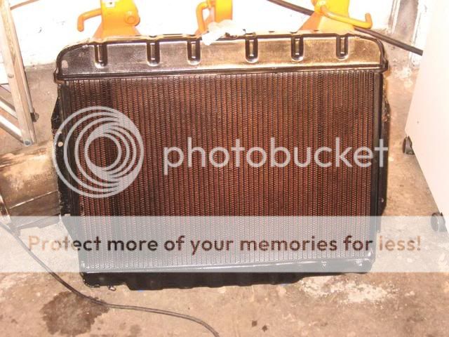

I had to get a new 3-core radiator from Radiator Barn. My old one fell apart. :lol:

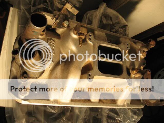

And I used the new parts cleaner to get all the grime off the intake and valve covers. You couldn't even see the aluminum before I started cleaning.
