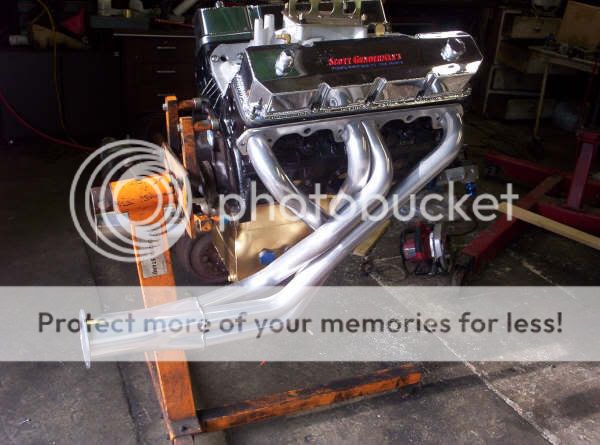

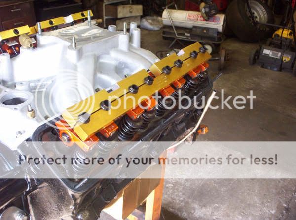

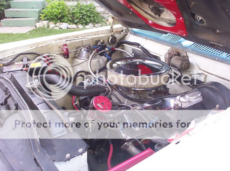

BREK What kind of rocker & girdle setup is that? I really like the valvecovers, where did they come from & how much? Yeah 290 :^o
Rebel25A Harland Sharp 7/16 stud rockers...guide plates...and a Jomar stud girdle...valvetrain will handle alot more cam then the Comp solid I have in it...I have a tendency to build stuff stronger then it need be...head studs...main studs...polished rods...with a 7200 redline...that a bunch of RPM for a 290
Rebel25A Oh...and those valve covers are one of one...meaning I had them made to my spec...the rails are 1/2 thick...I got more in them then they are worth but I wanted something nobody else had...they are right at 500.00 with all the options I added
