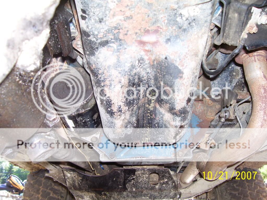

Well this weekend i crunched my oilpan on a little stump hiding in the tall grass. It pushed it up into my crank, i think a conn rod was hitting it. Have some shavings in the oil, hopefully the filter takes care of them. But i pulled the pan and the pickup is all mushed up too. So i was wondering what is the procedure for changing, i guess i need to pull the passenger side motor mounts in order to sping that thing in there.
Thanks
Pat
I'm thinking you may have to pull one of the main caps too (#3 ?). Never tried to take a pickup off with the engine still in the vehicle. You must have mashed it pretty good.

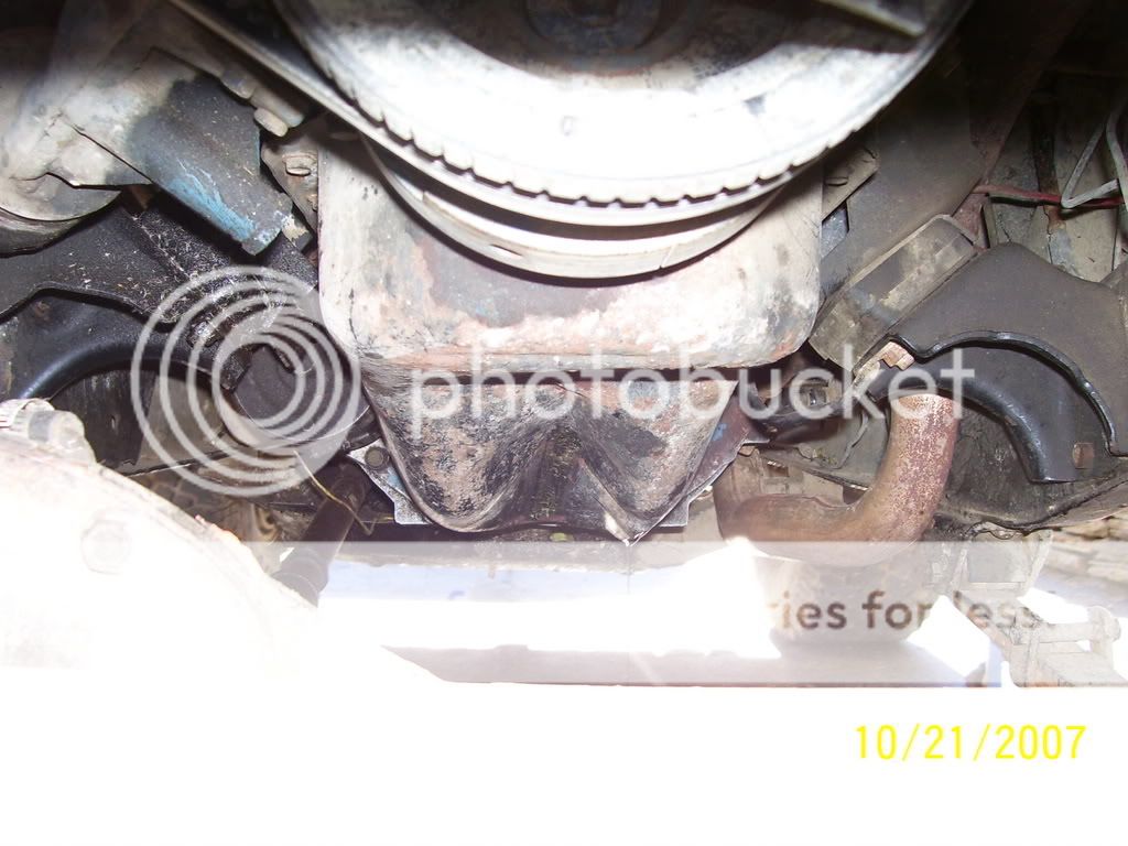

and if you look closely at the front of the V dent you can see two dents perpendicular in direction to the V that is where the connecting rod bolts hit.
Soylent_Green
Woah. Makes you want a oil pan skidplate doesn't it?
Patf10
yea all cause a damn beaver stump. big question now is can i get the pickup on with the engine in?
Soylent_Green
I hardly ever work on jeeps so I'm not sure. If you can get the pan off inbetween those motor mounts, you shouldn't have a prolem, I would think. You may have to unbolt the mounts and raise the motor some to get the pan back into place.
