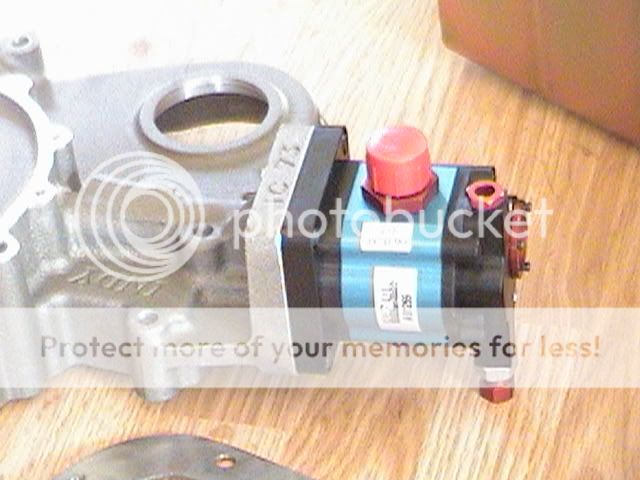

I went with Indy for several reasons, I wanted a cover that I could rebuild myself and the cover machined for roller cam buttons. I also have the Moroso dual oil pick-up and 8qt pan. I run dual filters with Filter Mags on them to pick up any fine crap in the oil...yes they do work!
The Indy cover has no way to pump oil into the block...you have to plumb it in (I used the oil sender hole and had it drilled and tapped bigger) The pump is basically a single stage dry sump pump.
I dumped a bunch of money into this motor at the start with parts that I could grown HP with and not upgrade again. I won't recommend the Indy cover unless you have the block stripped bear and are doing a high pref. motor rebuild.
If you like braided lines running everywhere then its the cover for you...personally I'd be alittle scared to take my truck where something could caught one of those lines coming out of my oil pan. But I didn't build this motor for 4wheeling through the back 40 lol :?:
