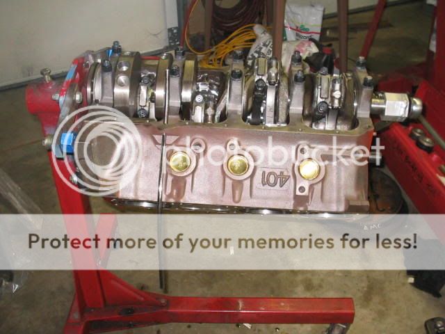

tufcj No benefits, only poorer performance because the bigger displacement engines need to breathe. The only way to truly date the engine is from the valve cover tag. A 1" or so square tag, usually on the front of the passenger cover (it may be on the rear of the driver side if the covers were reversed). Usually, it's long gone. There may be the last digit, or 2 digits of the year cast into the head between the rockers, or into the lifter galley. Either way, you need to pull the valve covers or manifold. You probably know, the displacement is cast into the side of the block, right under the motor mount bracket, between the freeze plugs. Bob tufcj
fuzz401 You probably know, the displacement is cast into the side of the block, right under the motor mount bracket, between the freeze plugs
mr.vic thanks for the information, it doesn't make sense to put the 304 heads on the 360 motor. nice pic fuzz, that 401 looks like it is going to be a monster :lo1l:
