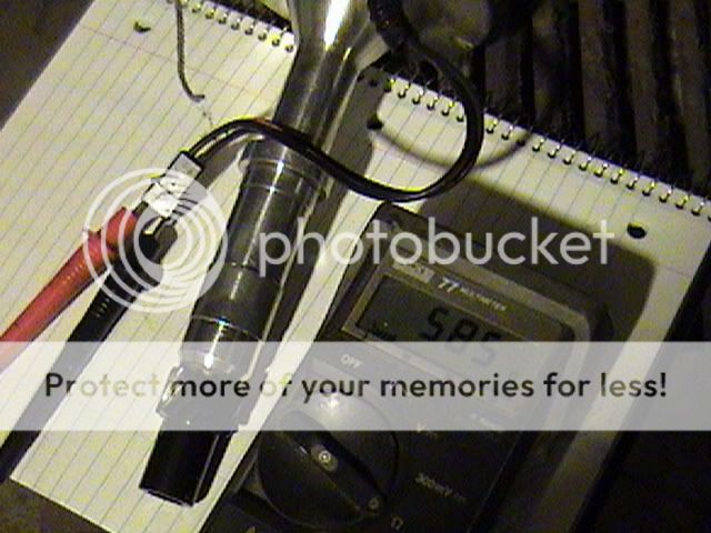

So there I sit with my son in the truck and 30 cars behind me and the dang thing won't even fire. Luckily a guy I knew was behind me and pushed me off to a side street. Talk about embarrassing. :oops: After looking into the problem and calling MSD tech it seems the pick-up coil went on the dissy. Even though the ohms reads ok...(MSDBillet, 6AL and timing computer)

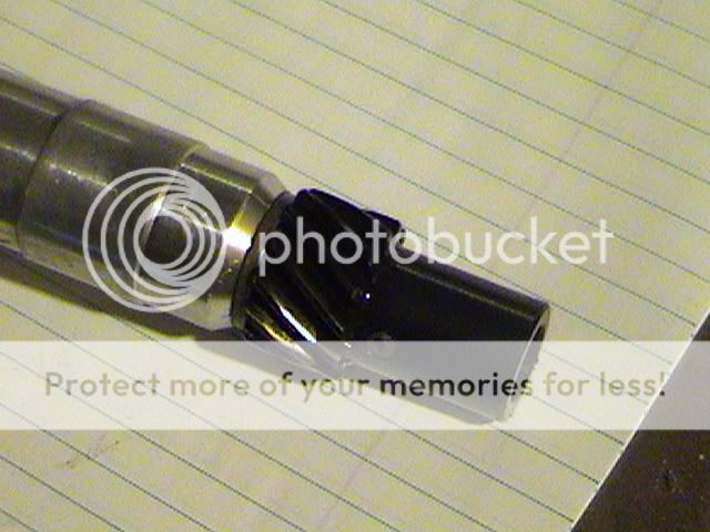

I pulled the dissy to check it and the gears...look fine but spinning the dissy some times makes coil fire and some times doesn't #-o
