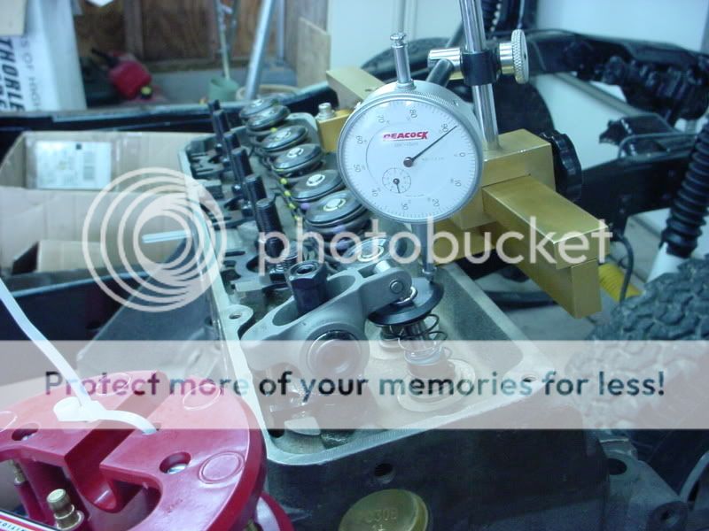

I not exactly sure what you mean by "move around", but here's what I can describe:
When the lifter is on the heal of the cam - I can rotate the push rod in the cups by hand, but have no noticeable end play. And I can move or twist the rocker side to side a little bit, but again no end play at the push rod or the valve stem that is noticeable.
What I did to adjust lash in the beginning was using a dial indicator, I set the lifter preload to .035" to .040" when the lifter was on the heal of the cam. (Spec was .020" - .060"). I was careful to let the lifter bleed down as I adjusted the preload and to start the measurement at zero end play.
When that was not successful, I switched to the Chevy method, adjusting while idling at oper. temp: back off the adjuster until it clatters and tighten 1/4 turn at a time to 3/4 to 1 turn once the clatter quiets down.
While adjusting using the Chevy method I did not notice much change in the ticking, once the clatter stopped.....in other words after the first 1/4 turn past the clatter, which would be about .015" preload, no better than at 3/4 turn (.045").
