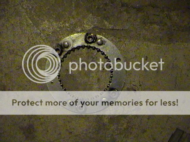

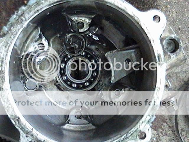

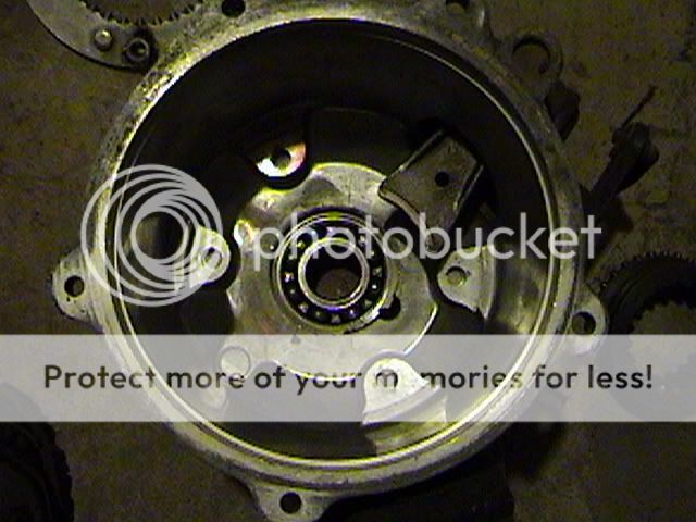

Welded some nuts on the back side of the plate that broke loose last year...hoping that the nuts will prevent the plate from spinning around as they rest on the boss in the bottom of the low range case. 111!!!
(bottom of case)

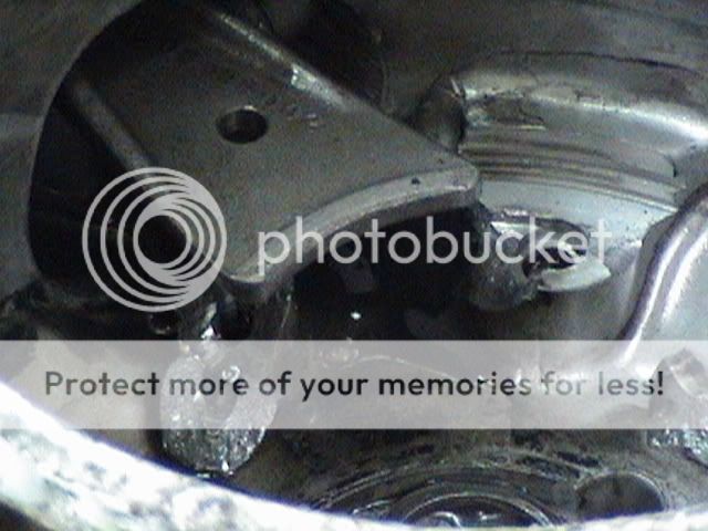

Last years mess...
Have a new chain and rebuilt dif in the case...any bets on what else will let go? Rear driveshaft? Front or rear dif? Low range again?
