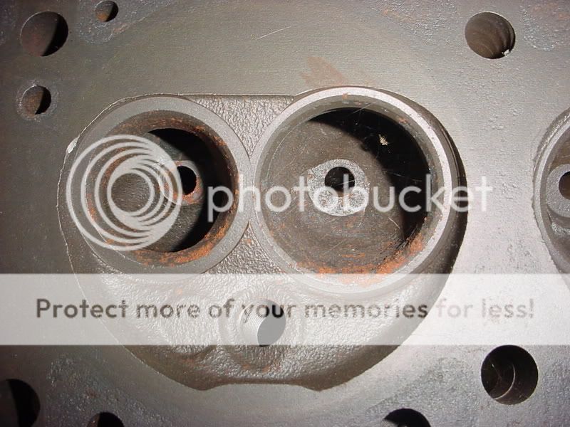

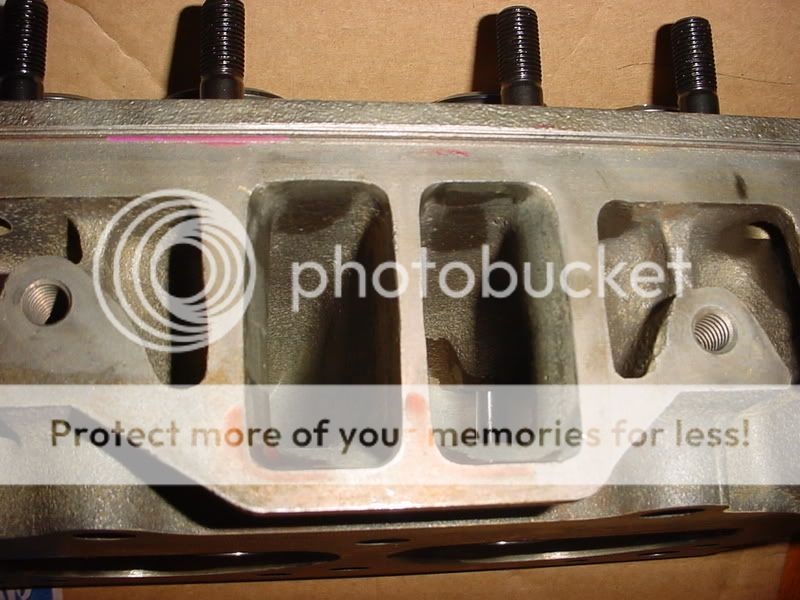

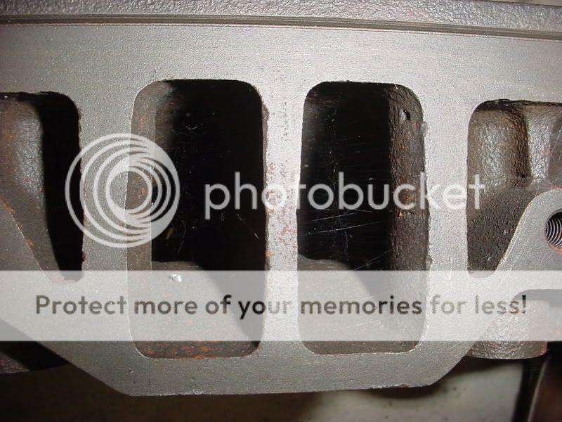

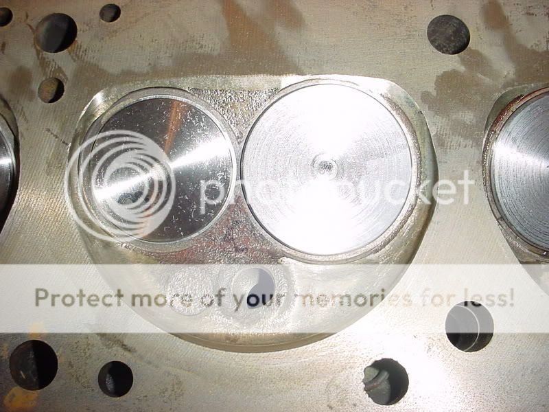

Here are some pics for comparison. Unfortunately I put the valves in so no pics of the bowls.
Stock Chamber
Modified Chamber
Stock Intake Port
Gasket Matched Intake Port
