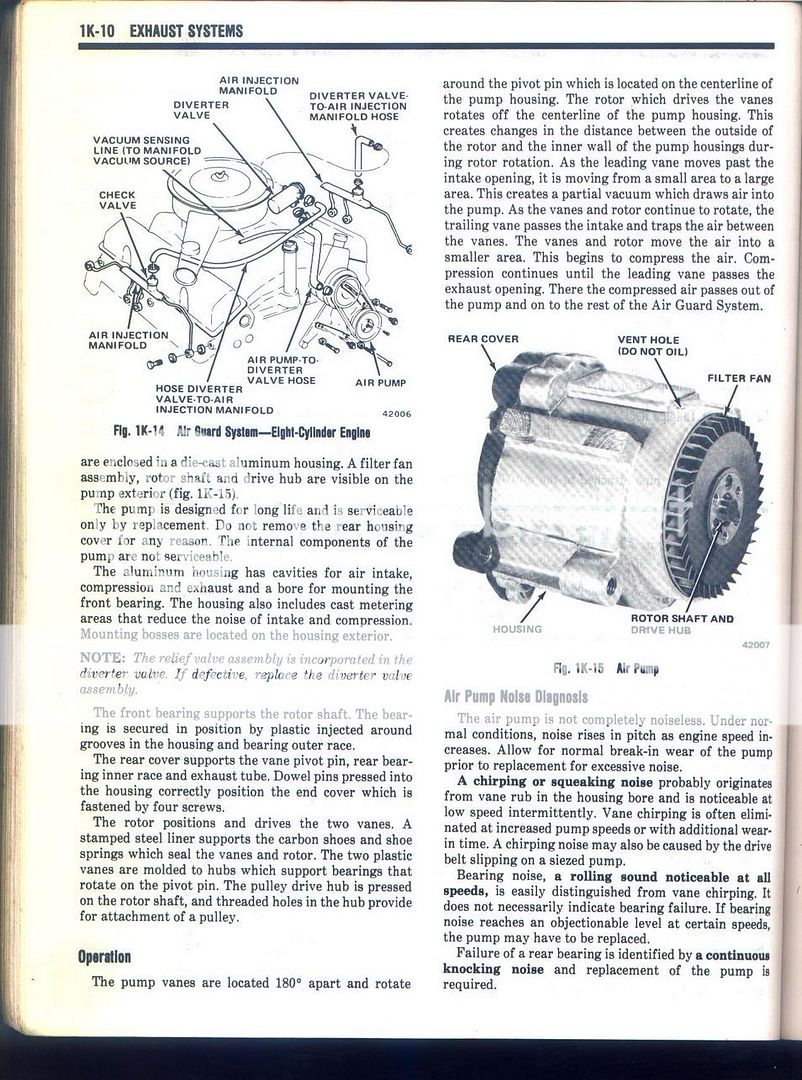

Fuzz, definitely not an Air Injection Reaction (AIR) system like shown in your picture. It was located up high, at least as high as the steering pump, and to the rear and further toward the driver's side from it.
