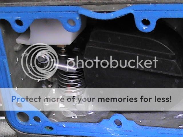

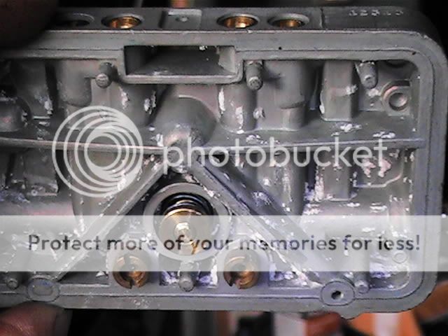

i'm useing the one for my power brakes back by the seconary pump, and the one big one up front passenger side for the pcv valve back to the rear of the intake, and the little one next to that one i have pluged, witch is my full manifold . vacumm, and then there's the one on the metering block for the vacumm advance. so after todays test drive, i let it cool down and take the carb off so i could try a different power valve. and this is what i found inside the bowl and the metering block :-| , i don't know, does'nt look normal. i'm gonna call ricky tomorrow and tell him what i found. anybody see this before.
AMX69PHATTY
Whatever it is it doesn't look right.
White "rust" from water in the gas, or "junk" in the fuel tank and lines ? Teflon Tape ?
There are small passages that it could cause problems with that's for sure.
And the blue gasket in the center where it is thin is messed up and wasn't sealing where it sags.
Was the seconday bowl also removed and contained the same ?

thats not good it looks like that carb has gas sitting in it for a long time and left corosion in it

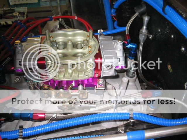

fuzz401
it is not that big
to this
