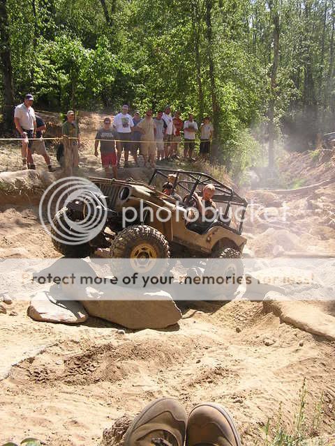

neptco19 Thats good to know, Im just wanting a little more power when Im having some trouble getting over a "little" rock 😃 Heres what its going in...
jeepsr4ever ! Jeep looks great! I am not sure if rocks and NOS should even be in the same sentence. :?:
fifesjeep :shock: Dude, you have to film it when you're going over a "Little" rock and you punch the NO2... :happy1: I want to see the Jeep launch and then toss a rod out the side of the block :razz: I can't imagine NO2 and and rock crawling... that in-itself should be a sport all to it's own... Sort of like Rock Racing.. CRAZY! (Love to watch it)
