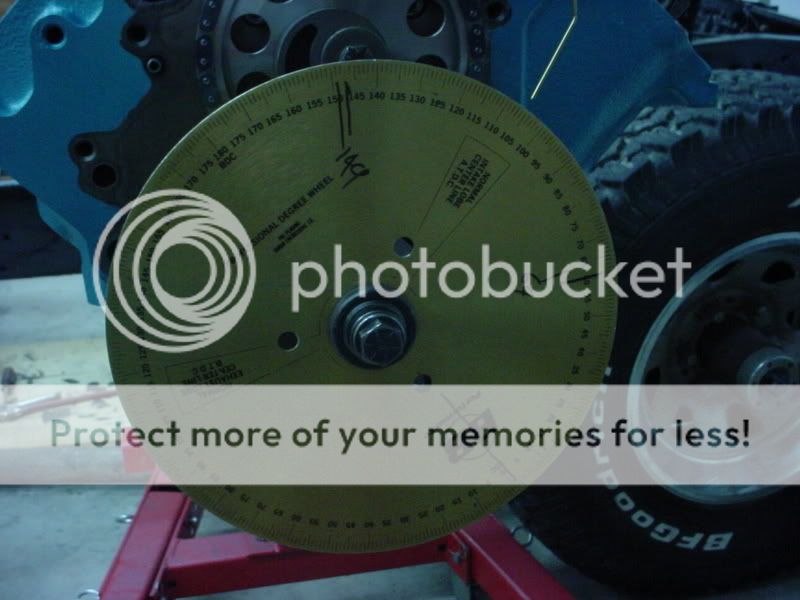

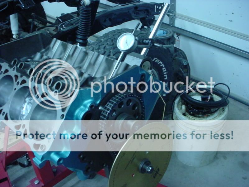

When I tried to degree the cam, it seems way off, but I am having issues trying to degree with the heads on and hydraulic lifters. I'm going to turn an old hydraulic lifter into a solid first chance I get and check it again, but that won't happen until next weekend.
