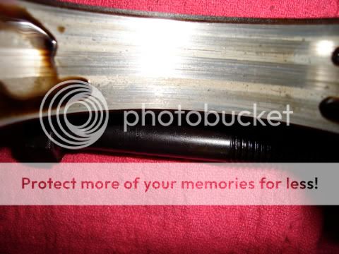

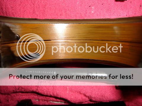

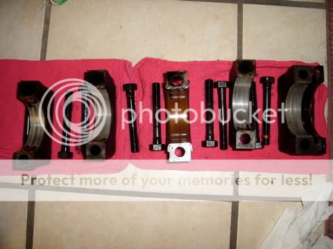

dbesade wroteBlown7 wroteYep they look like old bearings, don't worry about them at this point. It's what the crankshaft looks like and measures out that counts. Is there any fretting on the main caps?

Fretting is the minute movement of the cap rubbing on the block.It can be identified by a disappearing of the original machining marks. The surface material has a non directional sometimes shiny area. It can be caused by the cap to block mating surfaces not being flat, parallel and square to each other even when the cap is fully torqued. Sometimes if allowed to proceed long enough you'll have the kind of wear pattern you have on the number three thrust bearing. Also if the number three main journal is out of round you'll see that kind of wear pattern. The important part is to have the crankshaft inspected and inspect the block cap area, if all is well, everything else is just the previous history. You'll be writing a new history when it's all overhauled.
