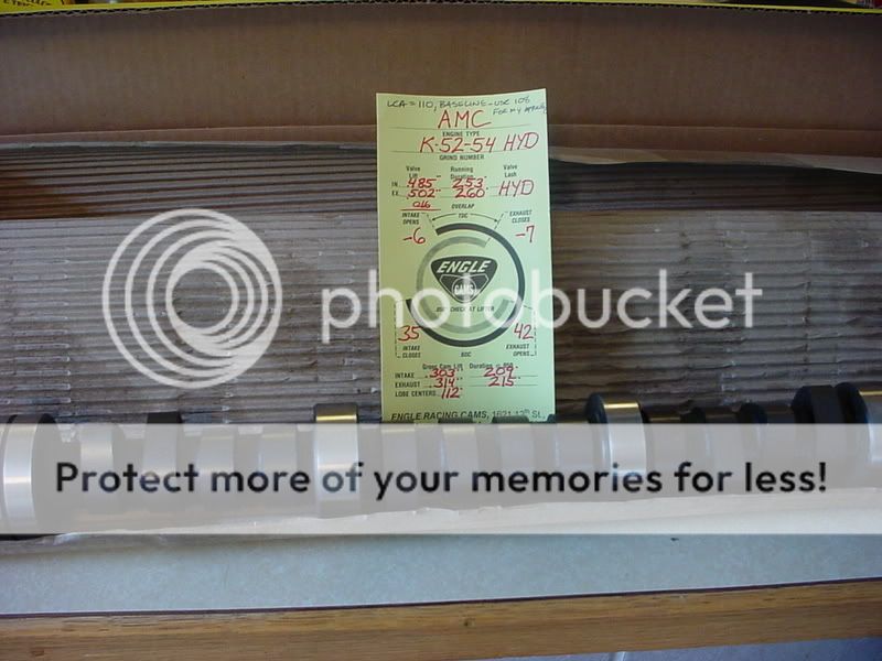

Might dyno it. Not ready to commit to that yet though and would need to come up with a bellhousing.
"Hydraulic Intensity" (as defined by Harvey Crane):
The ideal cam profile would raise the valves to full lift instantly, hold them open for a specified duration and then close them instantly. The laws of physics make it impossible to achieve instantaneous valve opening and closing, but recent advancements in design technology have made it possible to open and close the valves with more area under the lift curve. By so doing, engine efficiency is improved because the valves spend less time at very low lift.
Hydraulic Intensity may be computed by subtracting duration at .050" tappet lift from duration at .006" tappet lift. A lower number translates to more low end power, without any loss of top end power, and solves many complaints of poor idle quality. It also means it may be practical to install a cam with slightly longer duration at .050" cam lift than might otherwise be practical.
In practical terms, if two cams have the same duration at .050" lift, maximum torque and horsepower will be almost identical. However, the cam with the smaller Hydraulic Intensity figure will have a smoother idle, better off-idle response, superior low speed drive-ability, and a broader power curve.
PS: Nice thing about AMC engines is their big diameter lifters to take max advantage of this.
