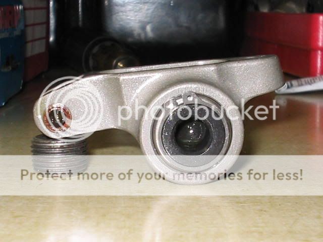

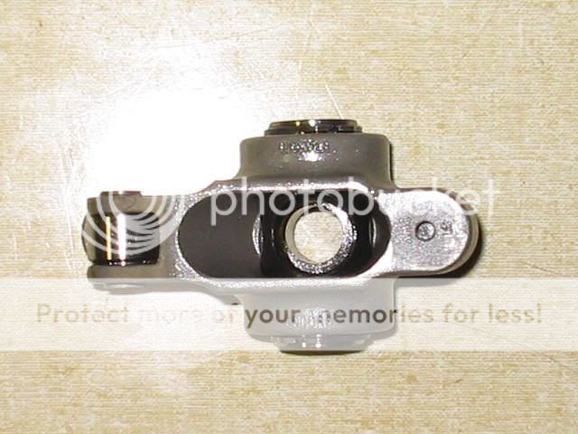

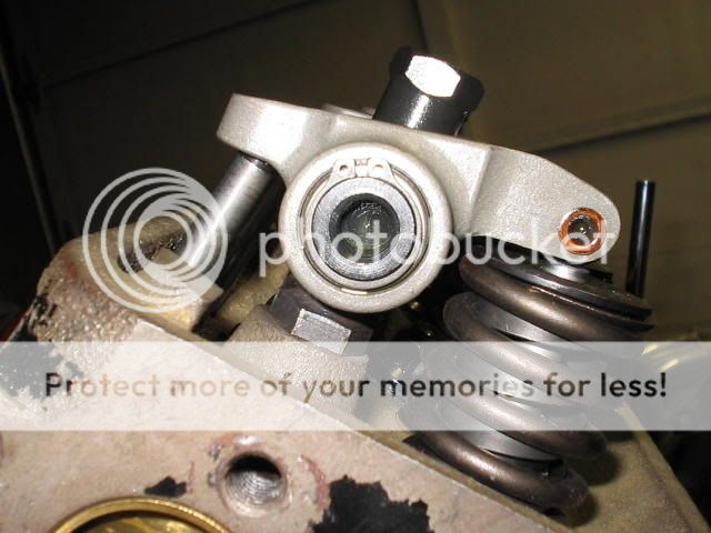

fuzz401 crower SS rockers what they look like my contact pattern on the valve tip crower push rods made to my length
82Waggy Not sure how critical it is, and you guys seem to be doing OK with what you are doing using the cast slots (no guide plates), but some think it is an advantage to stabilize a roller rocker as high up the pushrod as you can get without hitting it. Reasoning seems to be that rollers don't often have as wide a contact surface with the tip of the valve stem as a non-roller (stock type) rocker, and it is therefore not as forgiving of being off center as a stock rocker is.
