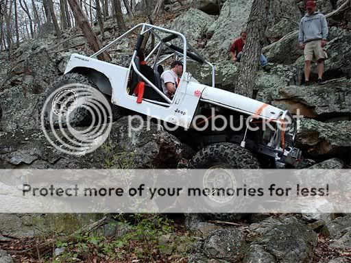

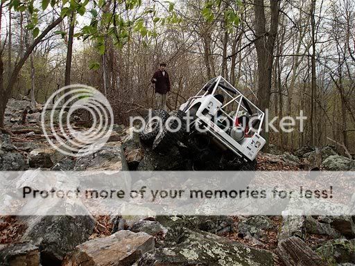

And pics: :lo1l:
[img]http://i27.photobucket.com/albums/c197/CoveJeepsPA/insanity1.jpg[/img]
[img]http://i27.photobucket.com/albums/c197/CoveJeepsPA/insanity2.jpg[/img]
runnamuck
paragon?
dan58
[quote=runnamuck]paragon?[/quote]
Gore, Va. [url]www.bigdogsoffroad.com[/url]
Paragon is closed. :smile:
