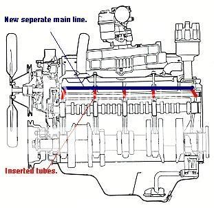

Don't know if that would be better...UNLESS a person would take it one step further...Now this may sound "out there" but some of these ideas come up after a few too many beers. :razz: 111!!! :razz:
What if a person drilled the mains like in the posts of "Extreme Mains" then drilled all the way to the inside of the valley to locate the main bearing feeds.
Then drill or tap the hole bigger at the top, insert a tube (either thread or epoxy it in place, braze?) that will be feed by a separate line or pipe.
Since the line in the mains now is blocked by the tubes you could use the valley line method to get oil in-between the tubes to oil the lifters.
Of course the tubes would have to oil tight at top also in the valley.
Oil for the new main oil line could be supplied by a separate pump line (Indy cover or another "out port" on MC's new cover he's working on??!) to assure a good unrestricted oil supply.
I know, I know...it's probably possible, but would be ALOT of work and add many spots for failure at joints...but if you tear down every so often it's no big deal to test and check things.
