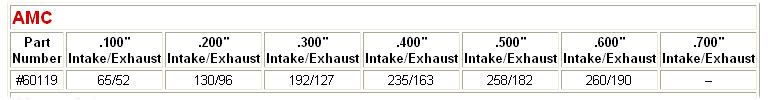

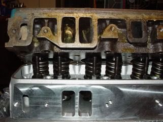

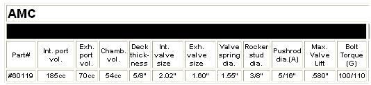

Here is a set of Edelbrock Performer RPM heads for the AMC V8 vs. a set of untouched 3196291-c heads (52cc dogleg heads made in 1970). You will see the ports on the Edelbrock heads are smaller in size when compared to the 291-c heads in some areas, larger in others but offer a smoother port. The Edelbrock's combustion chamber is superior to the stock 291-c's chambers. Edelbrock claims these flow #'s

Now we are flow testing these heads as I speak and will post up real world numbers. We will also be doing very basic port work and re-flowing the heads.

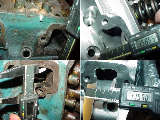

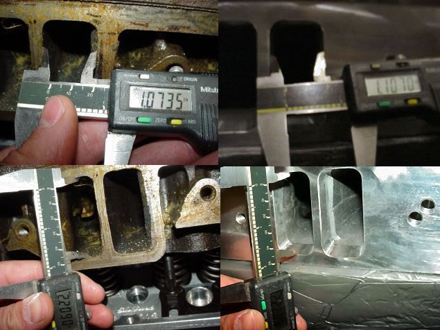

Now here we show the port size differences...they are slightly off. Its hard to measure these accurately with a caliper :idea: :?:
Looks like some room for exhaust gasket porting :?:
These are later model Waggy gaskets...not for performance use. I will not be using these gaskets but look at all that extra meat!
