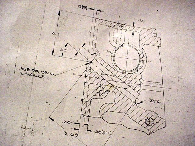

fifesjeep I'm not sure the method or methods that they used but, I'm going to go to the Junk yard or grab a pair off of my buddy and I'm going to play with them in the Mill a little... I'll find-out just how much you can take... (Knowing that each head isn't casted the same but, for number wise I'll give the casting numbers of the heads that I use etc....
fifesjeep Sure, this will help to dial it in quicker... I like destroying things so this should be fun... :lo1l: Do you have the diagrams and measurements of the blocks?... Bolt holes/water jackets etc?... I'm not sure if I'll drill into a block due to not having a Jig to hold it etc.. I guess i could make one or have the CNC guys toy around with something...
Rogue Racer If you drill it to .625" and hit air, you can go to .750" and press in a piece of thin tubing. In fact, I have one pair of heads that were drilled to .875" and a .750" ID tube pressed in. Use some Loc-Tite sealer when you press it in.
