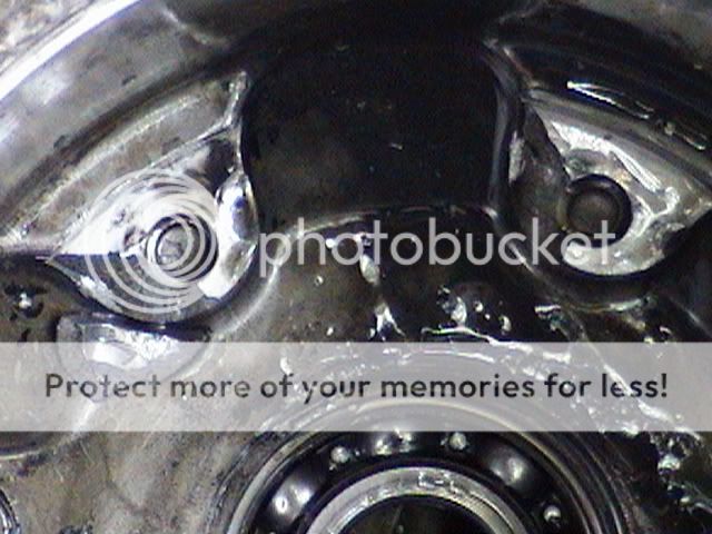

jeep_man_401 Well, I blew my low range on the transfer case at the fair the other night. It spun the plate in the back of the case. I did manage to take 4th out of 8 with a pull of around 167ft. Truck was loaded to 6050 pounds. Don't know what the sled weight was. Everything was going alright until I dropped it down to 1st gear (low range) to boost the RPM (It was only turning 3500 in 2nd low). I guess the 5600RPM with 460 hp and 460 torque doesn't sit well with a stock QT. :mrgreen: I'll try and post some pics soon. Meanwhile if anybody needs some gears for the low range I have them. They are in good shape...just the case is bad. :(:

jeep_man_401 I should have stayed in 2nd gear I guess. #-o http://s4.photobucket.com/albums/y116/jeep_man_401/?action=view&current=willmartruckpull.flv The damage... Looking for a 205 now...maybe make use of the 9" ford I have laying around also. :-|
