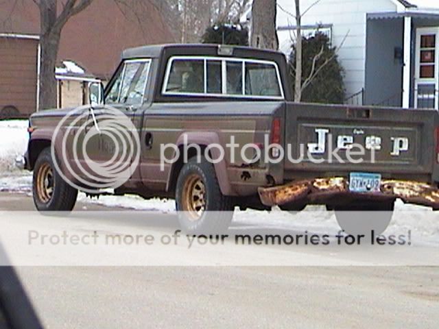

The super sleeper... :?
Look close and the air cleaners are visible... :lo1l:

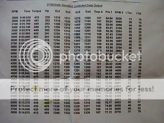

The dyno numbers on the motor...
The lowest RPM he could get his dyno to start a pull at...
Now I know, others have gotten allot more power out of 401's, but the Crower cam I order was dead nuts on for what they said was power and RPM of peak. I told them it was for pulling at the fairs and it was going to be driven on the street some.
I need some bigger headers also, something like 1 7/8"...the headman headers killed the flow out of the heads as they are to small. :-|
