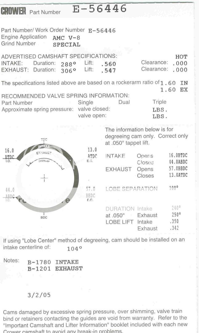

I wouldn't use this one in your 360 though.. :t:

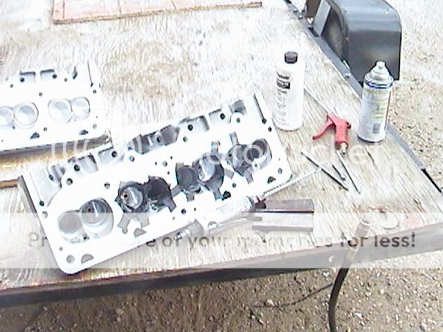

It was made using the flow numbers from my Indy heads.
I'll look for that cam card I have in my 360 this weekend and try and post it by Monday night. It's a milder cam but still had plenty of power and I would smoke many 350's and even a few 454's with it.
