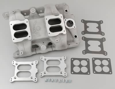

jeep_man_401 I am running the same intake on my Jeep with 2 X 600 Eldbrocks. I have some spacers I used before, but they were for going to a spreadbore pattern. The spaces in the pic should have cam with the intake. Mr. Gasket makes all sorts of spacers and adaptors. But I would shy away from short adaptors (like I had) as the mess with the intake flow.
