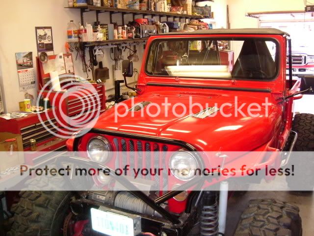

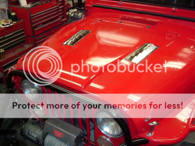

Here's pictures of my stainless steel louvered marine vents:
