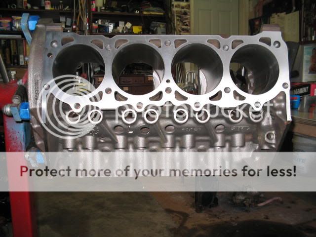

note this motor would be better in a car then a jeep more top end then low end
the block was bored .030 over
the pistons are Ross flat top with floating pins
stock crank balanced
cam I have a crower 292 solid lifter
6090 stock heads factory valves exhaust ported intake cleaned and the bowl cleaned up too
factory rods shot blasted polished and balanced for free floating pins
right now I have the air gap intake and a elde 750 carb going to try a modified torker intake on it next
