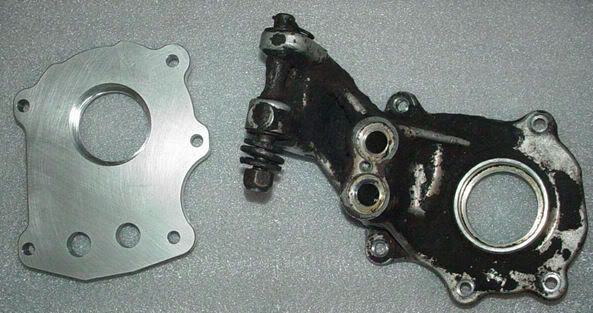

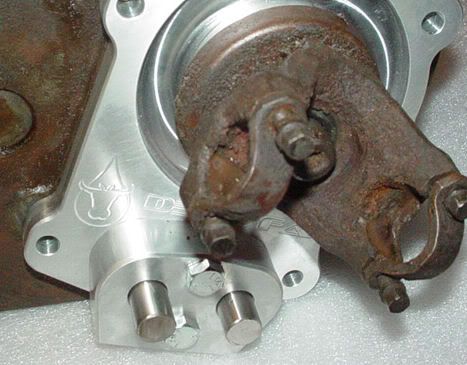

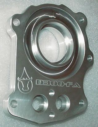

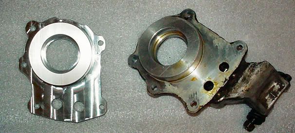

We are milling out protoypes and this is the idea ....ok
- A whole new face plate enabling the shortest shift rails
- A mount for a cable actuated system form the bottom of the case
- Face mount comes complete with seal and inner bearing race installed
- Face mount also comes with shift rails, bushings, orings installed
- Face mount allows yoke upgrades up to 1810
- Top plate milled for large 4-1 gears and has tapped holes for breathers, oil sight tube and fill
The whole point of this is to make a adaptor that allows you to completely replace the front casting/shifter rail assembly. This is a no brainer bolt in flip kit that a 5 year old could install with little supervision. We are nearing completion of the first kit as I type this. More on wednesday. We have a super trick cable shifter that will mount anywhere and make the current shift assemblies look like toys as well as kits to put a 20 case where a 300 was (more info later).
