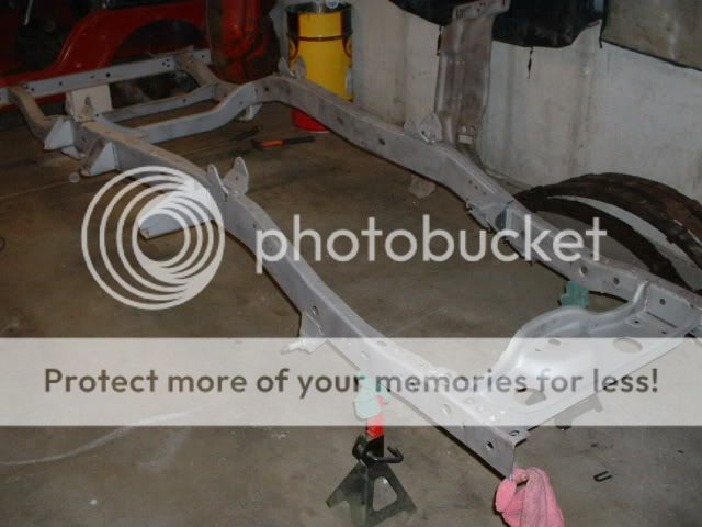

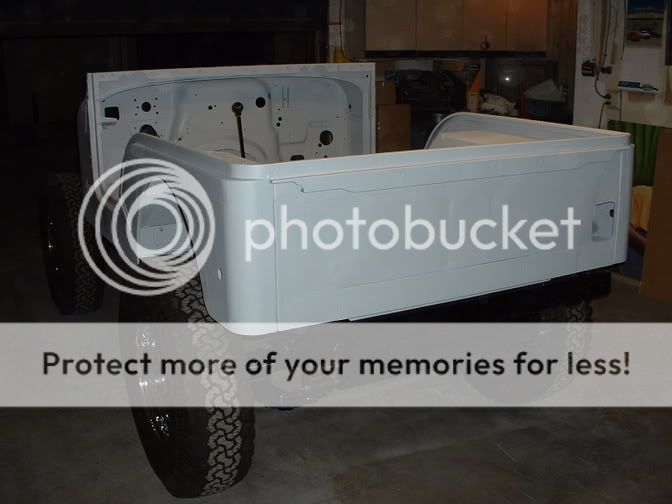

cobra5laddict started with this in oct of 04' :lo1l: .040 over 360 with howell TBI :t: i hope to have her back on the road this summer

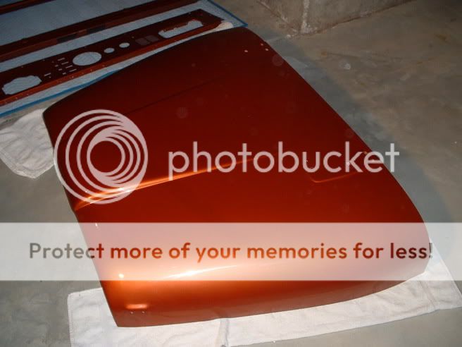

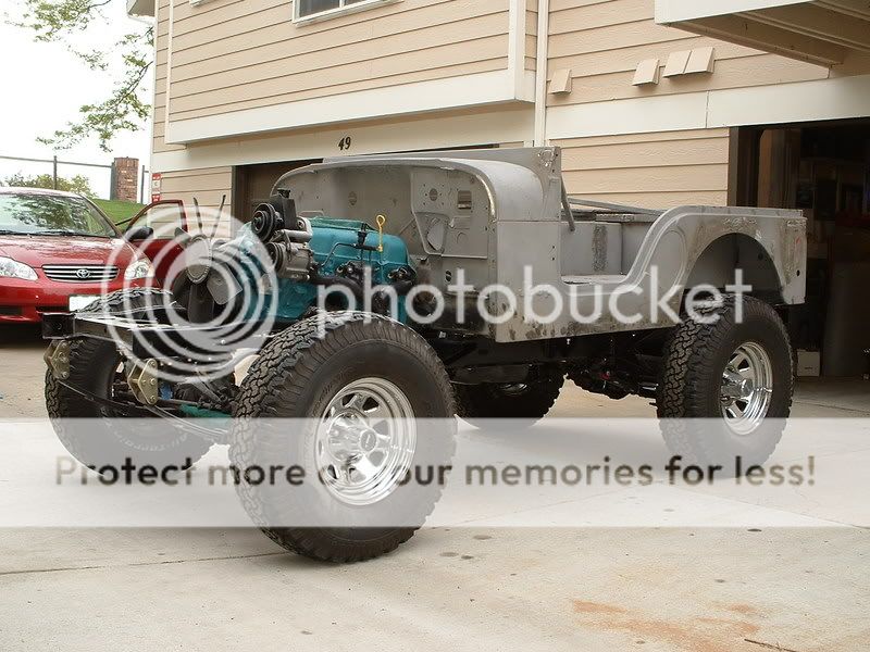

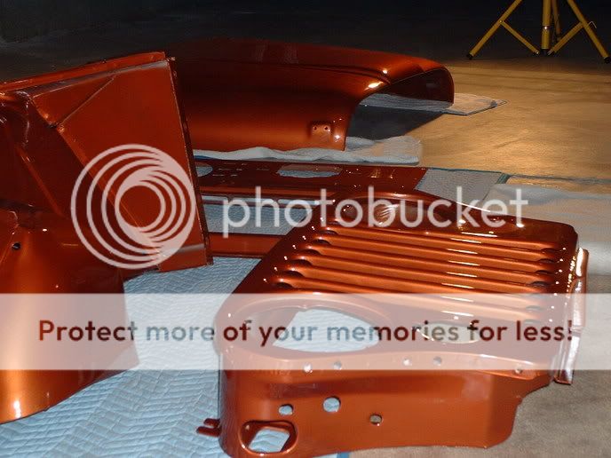

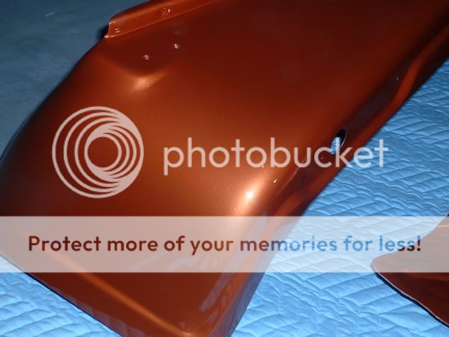

Lifted79CJ7 Daddy likes! What drivetrain are you running and what color is that? Looks kinda like the color they painted the truck on Trucks!. OK, here it is, was called Project Copperhead.

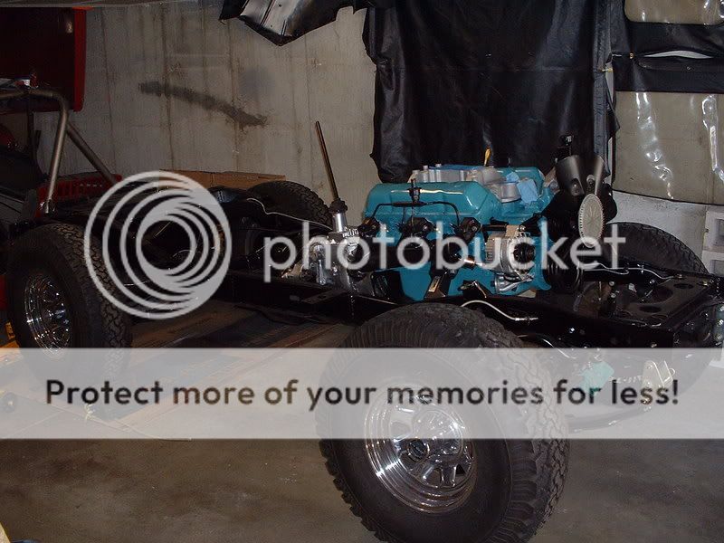

cobra5laddict it is copper but not that color from the show. the color is jeep wrangler color used from 2000 - 2002.. it is amber fire pearl coat. drivetrain: .040 360 with bulltear front cover and blueprinted pump. pretty much stock internals. :(: trans is t-176 (should hold up if i am easy on er') dana 300 t-case. wide track axles from a 86 cj7. dana 44 rear. gutless 2.73 highway gears 33-10.50 bfg at's (tall skinnys) howell tbi 50 state legal injection. j-20 steering box. jks disco's alcan custom 3.5 rear and 4" fron springs (for the 360 and a winch) 8274 winch p.s. p.b. 8)
