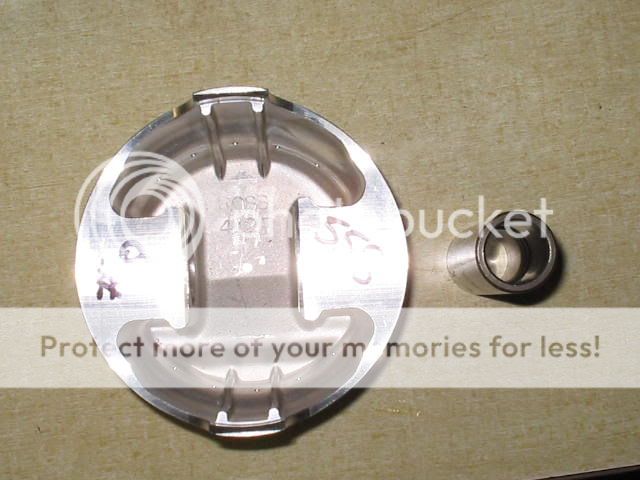

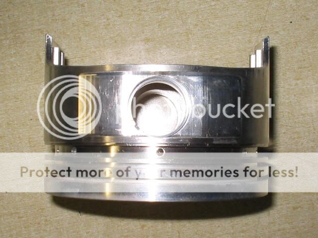

The 401 can use a quite healthy cam w/o any additional valve notching done to those TRW pistons, they are not even flattops, they have quite the dish and you will have to have some work done to get up to the 9.51 they claim. Which means you will be detonation prone more so than at 111. You will have a hard time getting the needed .040"~.045" piston head to cylinder head clearance with those pistons. I have a set here now that someone milled out like HDMD says to do. Had close to an eighth inch of clearance and would ping even with race gas. That's also called self-destruction. Those pistons have almost the same head design as stock, they may be exactly the same, and I recall they wee approved for NHRA stock class, which means they DO have stock dish. I think they use the big rings like the stockers as well (I may be wrong about that, do check). For performance, you should use 1/16" compression rings. If you have a couple of hundred extra bucks, go for TotalSeal gapless rings. They are worth an extra chunk of power (20 or more HP) after break-in, and should have 0% leakdown after break-in.
I would strongly advise AGAINST buying that kit, or any kit. Buy each piece to fit what you want to do with the engine.
The Ross 13.251 flattops are a much better way to go. They do have valve notches though they are not specific to AMC but generic. What year are your heads? If they are the later model ones and if someone is doing head work to open the combustion chamber, you could easily end up with 111 or less. Which would be OK with pump gas if your carburetion, timing, & cooling system are all in good repair and tuned correctly. It makes an enormous difference in power (around 50 HP in an engine built to run strong).
