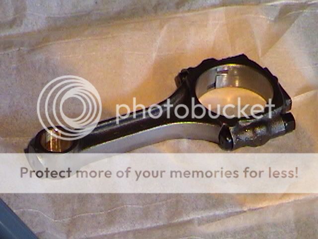

The rod... Bushed, drilled for pin oiling, APR rod bolts, polished beams and shot peened. :?

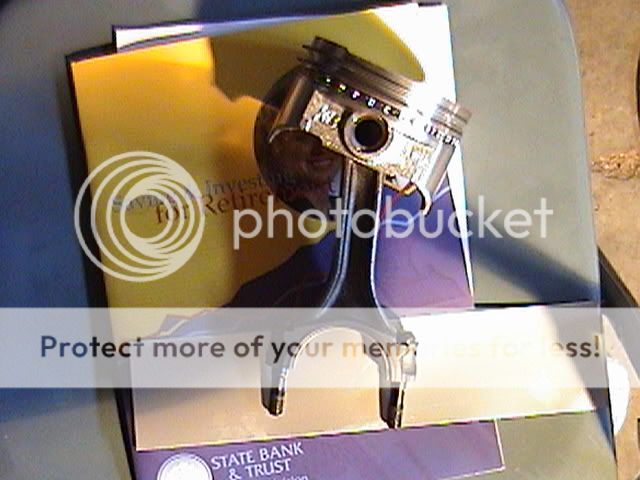

With 10.5 to 1 Keith Blacks and total seal rings.

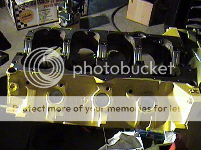

A pic of the oil holes I had tapped and drilled. The guy build up the hole with some brazing before dilling and tapping to beef up the area.
The bare block...

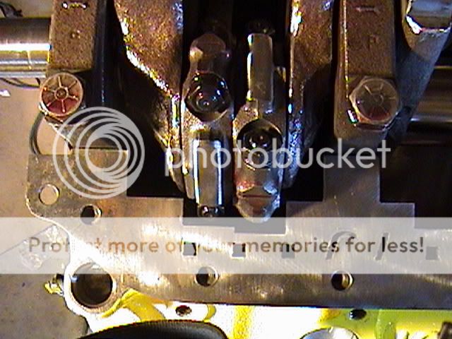

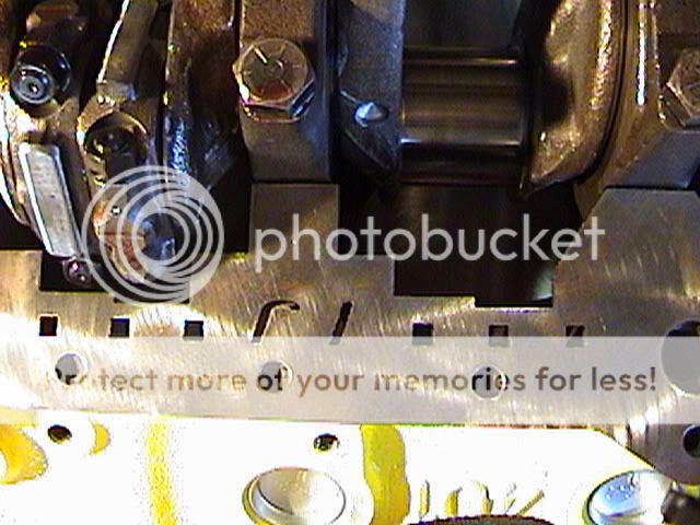

Checking the crank scraper I ordered...not happy with the amount of clearance they give you between rods and scaper. You could drive a VW between the two. 🙁: I may check and see if I can get one cut here and grind to fit myself. Any body intrested in buying a few? Maybe you guys could design a better one. :lo1l: That leaves no clearance and the person must grind to fit!??
