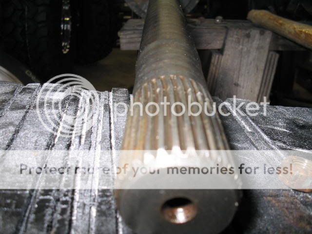

Well, got a lot deeper into this POS M20 axle. Trying to sort out axle shaft lengths to get replacements, I popped the cover back off to pull the pig and check the splines inside on the long side that spun.
Wanted to check wear pattern before I pulled it out to see if It needed to be reset when I put it back in ... But I found a WHOLE lot worse when I got in there other, than a bad wear pattern ...
