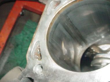

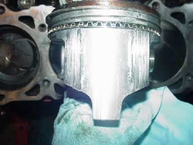

Fellow AMC'ers 360 he had in the shop this weekend. He lost oil pressure and gained heat and a really loud knock. Found 3 collapsed lifters, all the rods stretched and 2 cylinders on the passenger bank have scoring....heavy scoring
Poor fella needs a 360 for next week in colorado :-/ Also found the rings to have the gaps lined up!!!! This is a reconditioned motor
