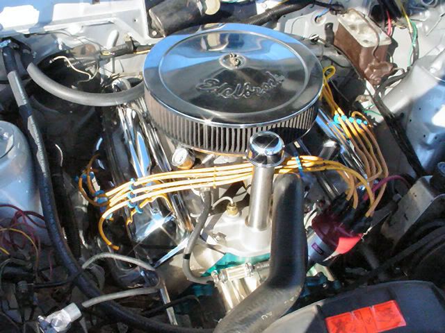

jeepsr4ever Chris had parts from the first run that edelbrock put out. I have some engine pics from his car I can post up. He had to take some off the heads for the first pipe. Other have run this combo without this issue. I believe it was a quality issue with the headers.

jeepsr4ever Very nice..I think you could have run better with a little more advance and a closed element air cleaner
