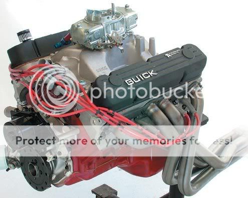

Looking for input. I have a 455 on the line and pondering putting it in my 82 J20. Now before you start bashing me for not using a AMC motor it's a Buick (remember the late 60's and early 70's)not a Chevy.
Issue being I want to have overdrive, I have a divorced T-case on the shelf so a 2wd trany will also work.

I think AA makes the adapter ring for putting a 700R4 behind that motor. build the hell out of the tranny. there is your od next i would run a married t-case if possible.
Also have seen the T400 with Road ranger unit between the tranny t-case i think that was how it was rigged up or it was bolted onto the output of the transfercase anyways my vot is for a 700r4 simple clean easy one unit not three

Buick 455 looks like it could be a "big block" AMC. :-|
Here's a link with a short overview of the engine pictured:
http://www.carcraft.com/techarticles/72278/index5.html

Oh and if you jump to advance adapters website they should have adapters for that. just keep in mind your making "Tractor" torque..whatever goes behind it should be stout, turbo 400 comes to mind and I wouldn't worry about the divorced t-case as long as it's well mounted.

Still have not got around to this project, things keep piling up in front of it. I'm thinking a divorced T-case will work to my advantage since it has a lift. The front shaft is plenty steep now but I might swttch to a HP Ford front since I have a few of them.
